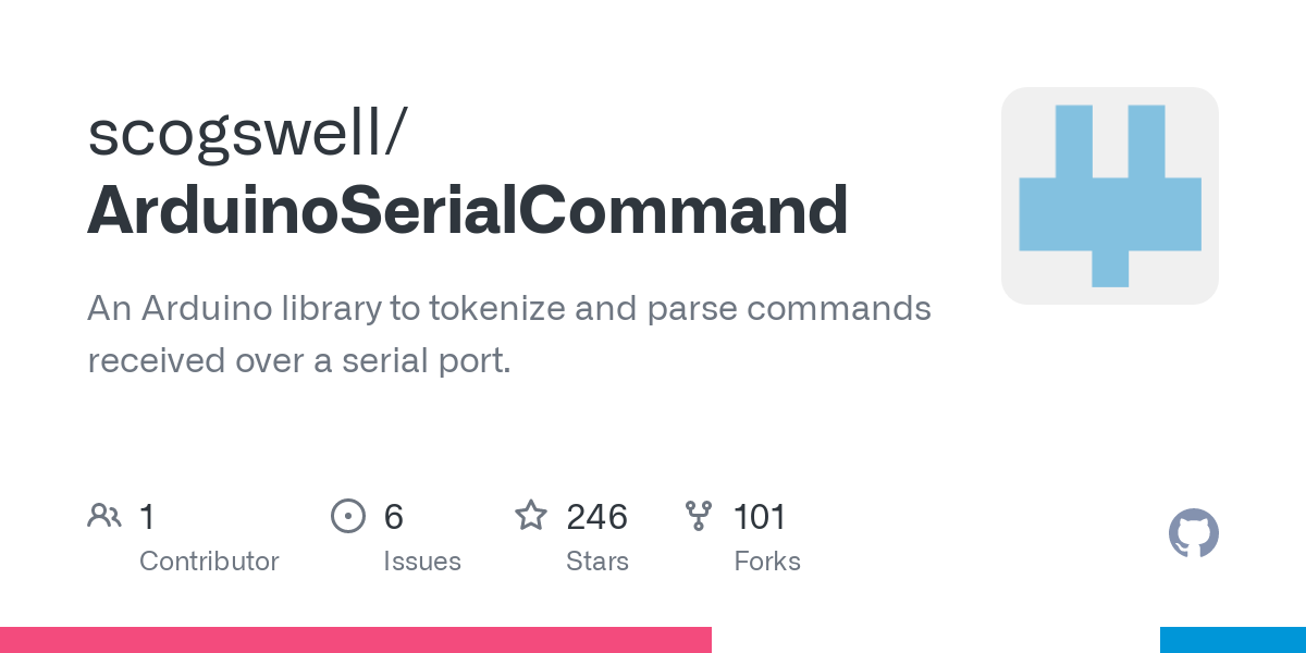

Sorry, this is a wrong library.
I found a library exactly what you asked for long ago, will post when i find it again.
meanwhile, try google!
