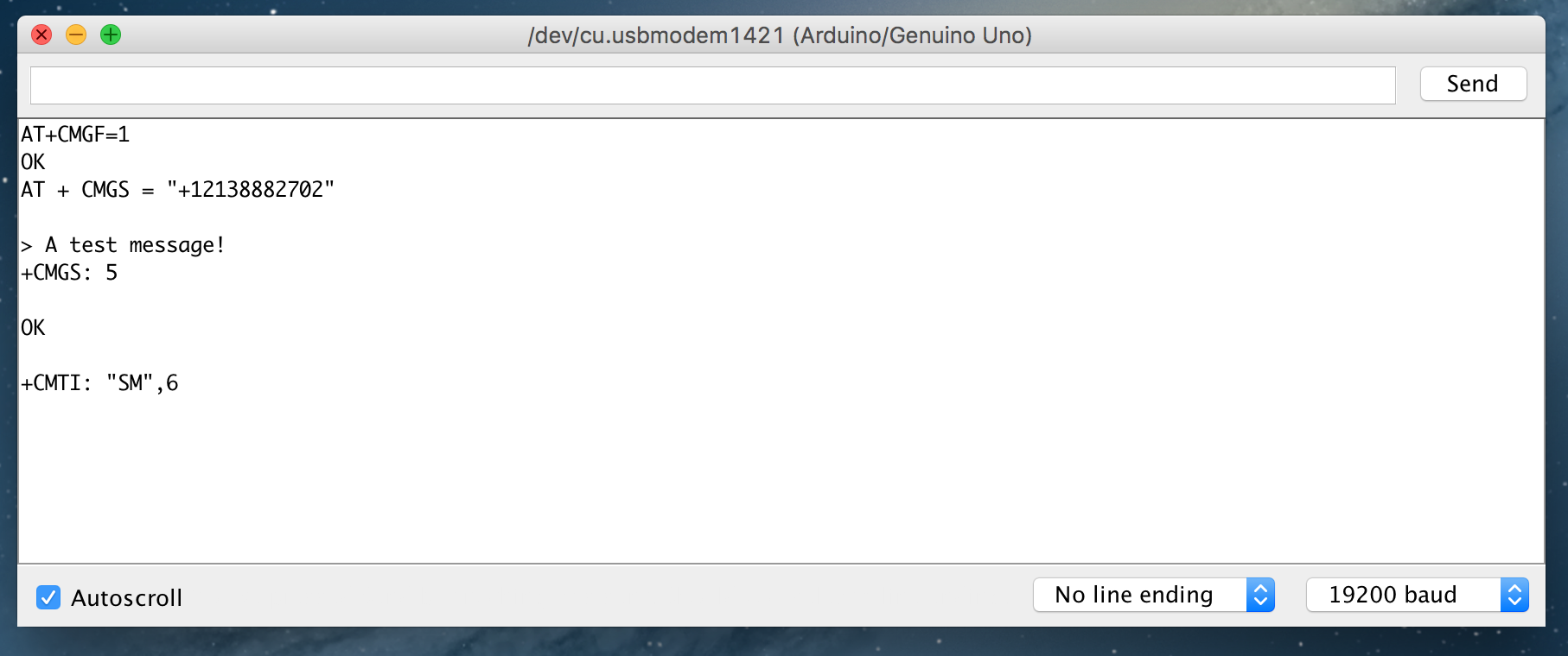

I am trying to receive a confirmation code from T-Mobile to set up my online account for this Pay-As-You-Go sim card. I am using an Arduino Uno R3 and Seeedstudios GPRS Shield V1.0 with the SIM900 module.
Current code below.
Here is what I am seeing in terminal after I sent a text message out and then went and requested a confirmation code from T-mobile's website:

mySerial.println("AT + CMGS = \"+12....are you sure about the spaces between AT and the + and the CMGS (and in the whole command basically)
Do not post pictures of text. Copy and paste the TEXT!
