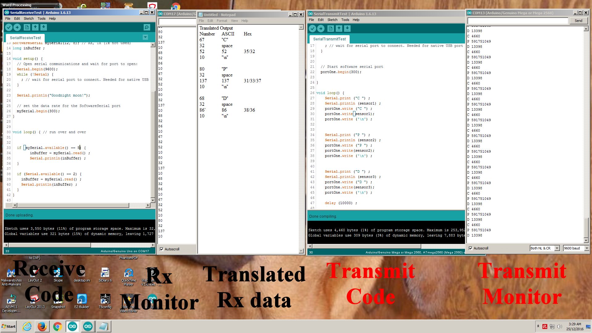

The attached SerialDebug.jpg shows the serial monitor of the transmit program, the serial monitor of the receive program (along with the ASCII/Hex translation of the data bytes.
When I try "portOne.write(sensor1, 2);" I get the errors in the attached MultiByte write errors.txt

Using the serial.print format gets all my digits through - they translate from decimal to ASCII the same way the transmit monitor displays them.
Now I have to figure out how to put the characters back into Binary to 'assemble' the original number.
I am using 300 BAUD because the serial is going through a noisy narrow bandwidth channel and requires some noise-removal, re-shaping, and level-shifting before going into the receiver serial port.

the errors are gone but I am not getting an output on the serial.print
When I print the value of counter, it is stuck at 9.
