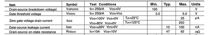

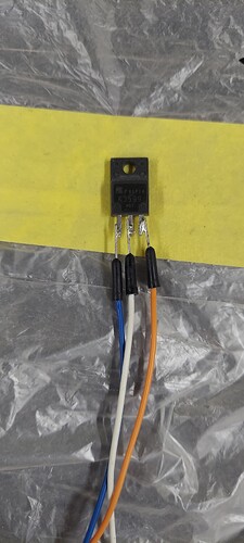

The FET K3599 I pulled one out of a broken PWM controller put it on a breadboard to figure out how to use it with the Arduino . Then i noticed the trace on the board for the control pin . On a good PWM controller I cut the trace and wired the control pin to the Arduino and Wala I could control it . As for the FET's not being suitable to be driven that way , that is entirely possible. I have no idea. This is what I mean when I say uneducated . I have had zero formal electronics education .

Yes this is a totally wrong FET to use, unless you can amplify the signals coming out of the Arduino to 10V, or more.
This shows the relevant part of the data sheet:-
The relevant parameter is called Drain source on resistance (Rdson). This is the voltage on the gate you have to get for the FET to turn on as hard as it can. Anything lower is in the what is called the linear mode, where it dissipates a lot of heat. So this would get "mad jumping hot" as my school metal work teacher used to say.

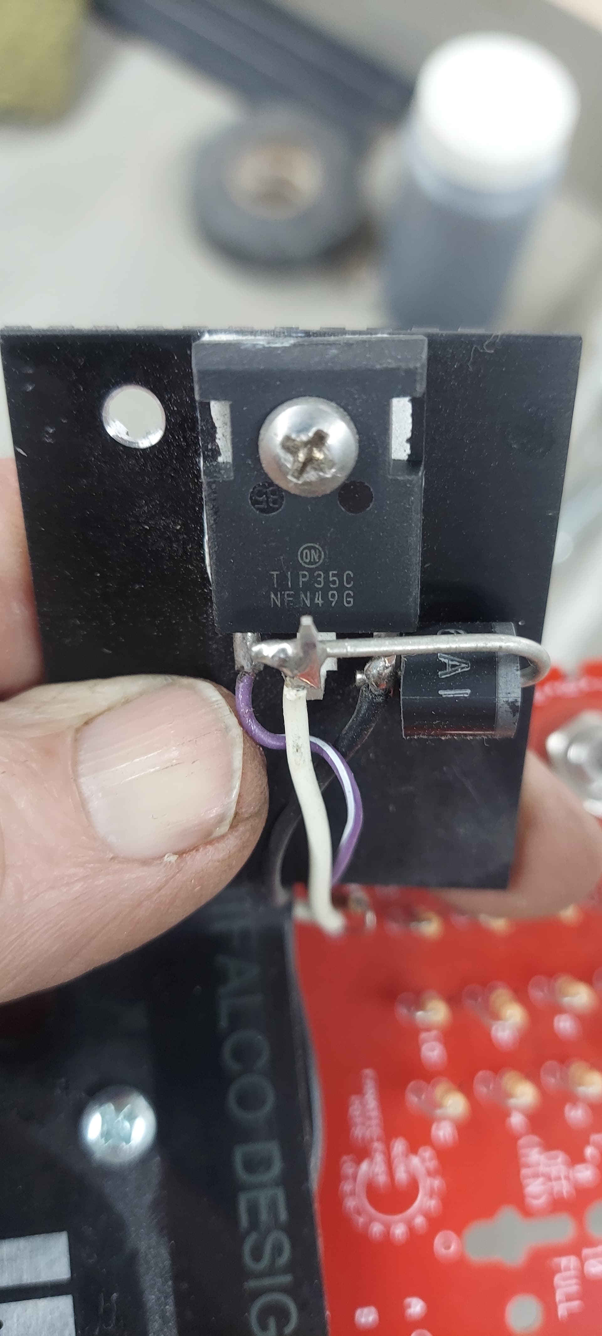

Also the wiring of the TIP35C looks wrong. This must have a resistor in series with the base, and I can't see one. So this could get very hot as well.
Which parts get hot?
Honestly I didn't check the controller. Just the car . So I was looking at the circuit on the pwm board. The out bound side ground plain is isolated from the rest of the board. Not sure if that means anything. Here's a couple pics top and bottom.

On TIP35C . It has boat load of resistors on the board . I'm sure it has one the resistor you speak of . The heatsink will get warm/hot depending on the car . Especially if it's a big magnet car. The TIP35C pics are the inside of the green controller. Laying on the track
