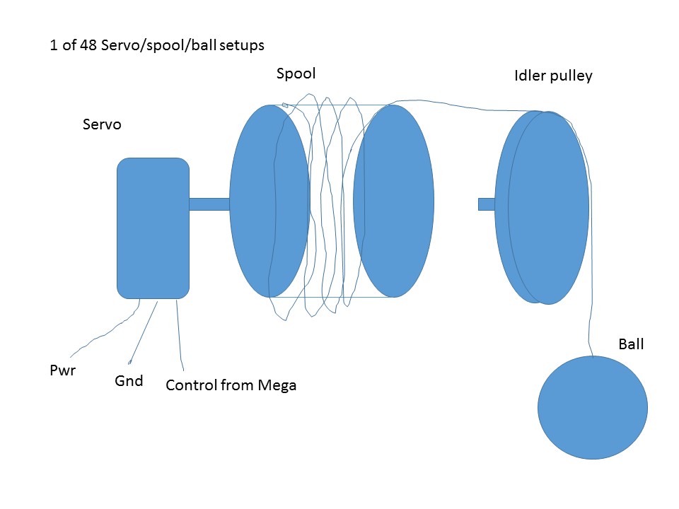

I'd try continuous rotation servos. Probably need to 'calibrate' them: maybe at first turn on you send serial command to raise each one by one to a known position, then each will have a spool of fishing line/string, and you know how many turns of the spool you command how far the end of the string will move.
Automate that even, use 3 16:1 muxes (ex. DG406) to read limit switches for calibration. 3 inputs, 4 channel selects, 48 servos, 2 lines for serial, 59 pins used, still have 11 free for other stuff.

So a setup like this (can't really show the 3D-ness of it, but I think it gets the idea across).
Try a couple of servo, see what's needed to lift 500g (~1 pound).
You might be surprised and find a Standard Servo is all you need, and the biggest part of the problem is securing the other end of the spool so it doesn't get twisted around by the weight of the ball.
DG406 - http://www.digikey.com/product-detail/en/intersil/DG406DJZ/DG406DJZ-ND/821393
This is a 16 input, 1 output analog switch. Wire each input to the ball position sensor, select which input you will read and move that ball until the input changes. You need 4 address lines to select the input, all 4 address lines can go to all 3 DG406s, each will have 1 output that would go to a unique input pin on the Mega.

thx ...are there also diameter calculaters for teh spools based on pull length per sec ?
Just basic math: circumference = 2 x Pi x Radius, or Pi x Diameter, circumference/Pi = diameter
Pi = 3.1415926535 (press the button on the calculator)
1 foot of travel per rotation = 12"/Pi = 3.8" diameter spool
