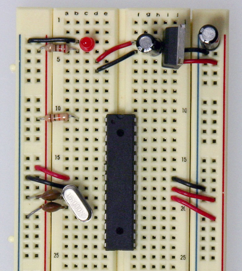

When I'm using a 12v 1000MA wall power supply on my breadboard arduino through a 7805 voltage regulator I can communicate with serial just fine, but when I connect my arduino to a DC/DC buck convertor that's being powered by a 36v DC transformer set at 12v out to the 7805 voltage regulator I get garbled serial data. I've read up on these DC/DC Convertors and they seem noisy. I have a 10uf capacitor before and after my 7805 regulator. Is there any other way to clean up the power? maybe use a bigger capacitor before the regulator?
my setup goes like this
120V to 36VDC Transformer (to high power LED's) to DC/DC Buck Convertor (to power 12v fans and arduino) to 7805 regulator to arduino
and yes, I've disconnected the LED's and Fans for testing, I still get a messed up serial output.

Show us a picture of your wiring.
Sorry, I don't have a picture at the moment, but my board is setup exactly like this
except where the 2 power connections are going to the 7805 regulator, it's just connected to the DC/DC Convertor to power it. So I should have a 0.1uf cap going from the negative of the 7805 to a ground source? which would be the case that the 36v power supply is housed in.
edit: now that I think about it, I do have the 36vdc negative connected to the 12v negative because I'm using a TIP120 transistor to control a 36v output (high power led), I can separate these with a 0.1uf cap if possible? And I'll check, but I'm sure the 36V is grounded to the power supply case, which is grounded to the 120v ground.
