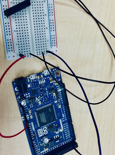

Let’s see a good image of the wiring.
I changed it now to what you recommended with the pullup. Meaning the reed swich is bettween PIN 24 and ground.. and also I changed the code to PULLUP. but still, same results
Do you still want to have a picture? It is just ground to pin24 that's it...
Good idea to see one.
Edit
I don’t have a Due to prove your results.
Ok the picture should be attached now
Don’t see a pull down resistor or the switch. :confused:
Not able to tell where the red wire is going.
Do you have the N and S poles of the magnet parallel to the reed switch? It will greatly reduce bounce.
