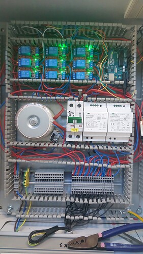

hello everyone,
i want to get relays to switch by sending characters into a bluetooth module HC-05. when i sent characters to the module nothing happens. someone who can help me with it?? im fairly new to using arduino so it could be that i made some stupid mistakes

i'm just sending the commands from my phone
As @lastchancename said, showing us your circuit diagram would help a lot
could you explain this in an easier language, it's my first time using arduino so i need to learn the language a little bit
Your relay modules don't work because they are not being powered.
You need a power supply to power them. You can power a single relay off an Arduino, maybe two. But not 9 relays.
You can't even power 1 relay from an Arduino powered by a 9V battery.
yeah my bad normally they are being powered by a 5V powersupply
Please post an accurate schematic (schematic, not wiring diagram).
the soil moisture sensor has to give a signal to pin 9
Good luck.

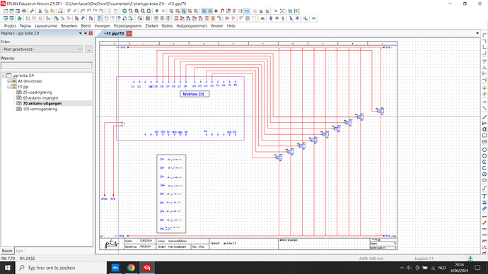

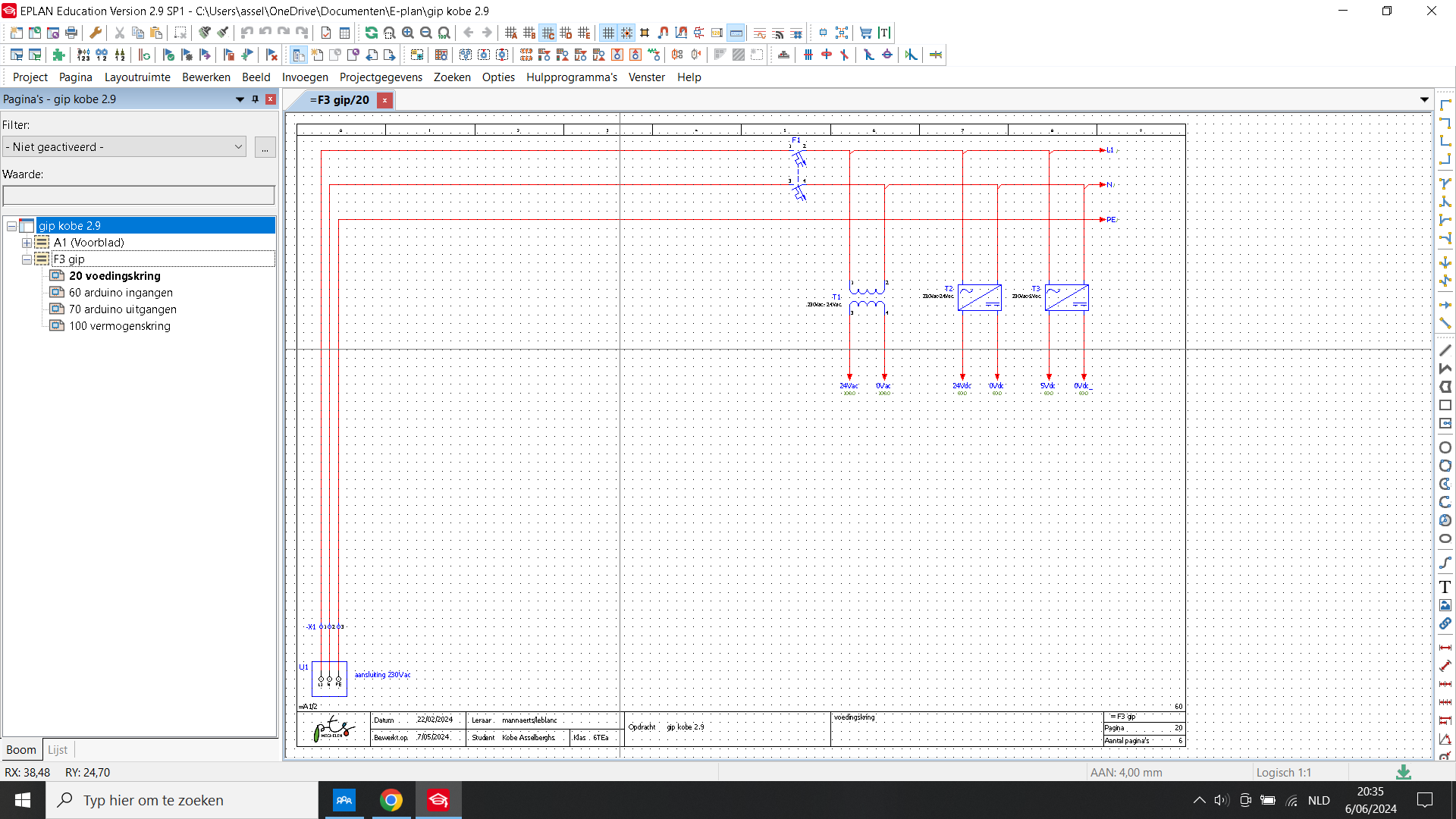

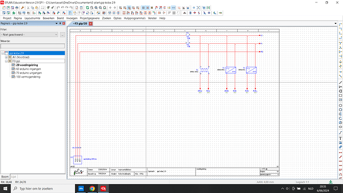

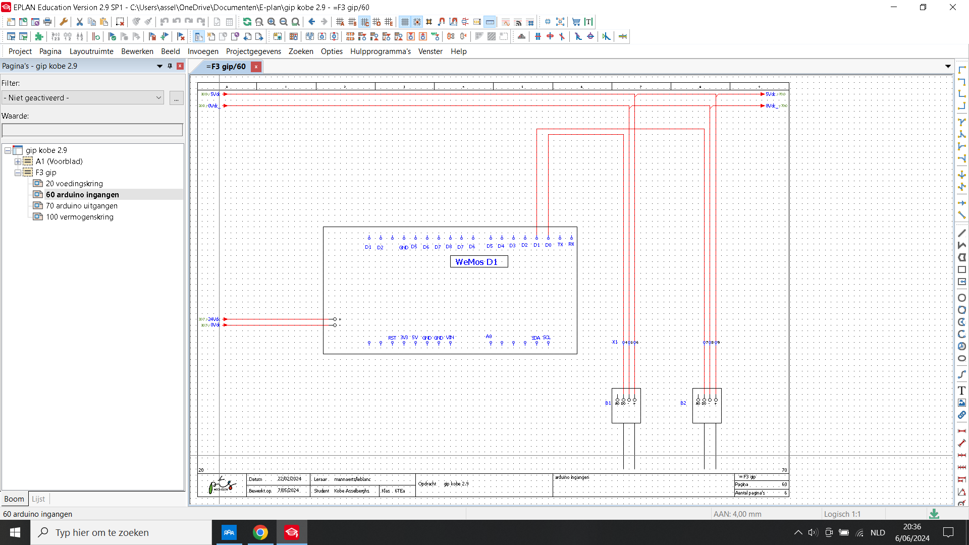

these are the schematics i made on e-plan around this project. this is the most accurate i have. it normally works with a wemos D1 R2 but i can't get the internet from school so i had to use a HC-05.
The ‘transformer’ at the lower left is curious.
Apart from anything else, you’re feeding the circuit with AC not DC
Why are you transmitting an 11 or 12 character ASCII string to represent the ON or OFF state of one valve? You could send one binary word (two bytes) to represent the states of all 9 valves at once.

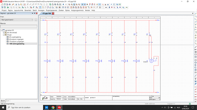

The valve on pin 9 has to work by the sensors on picture 3 off my eplan schematics. Valve on pin 12 has to work when any other valve opens. The rest work just randomly when u send to the HC-05 that they have to work, so they could all work apart or all togheter.
The valve's work on 24Vac.

E-plan should be able to EXPORT jpg images, check in the files tab.
Screen shots lack resolution and waste screen space.
