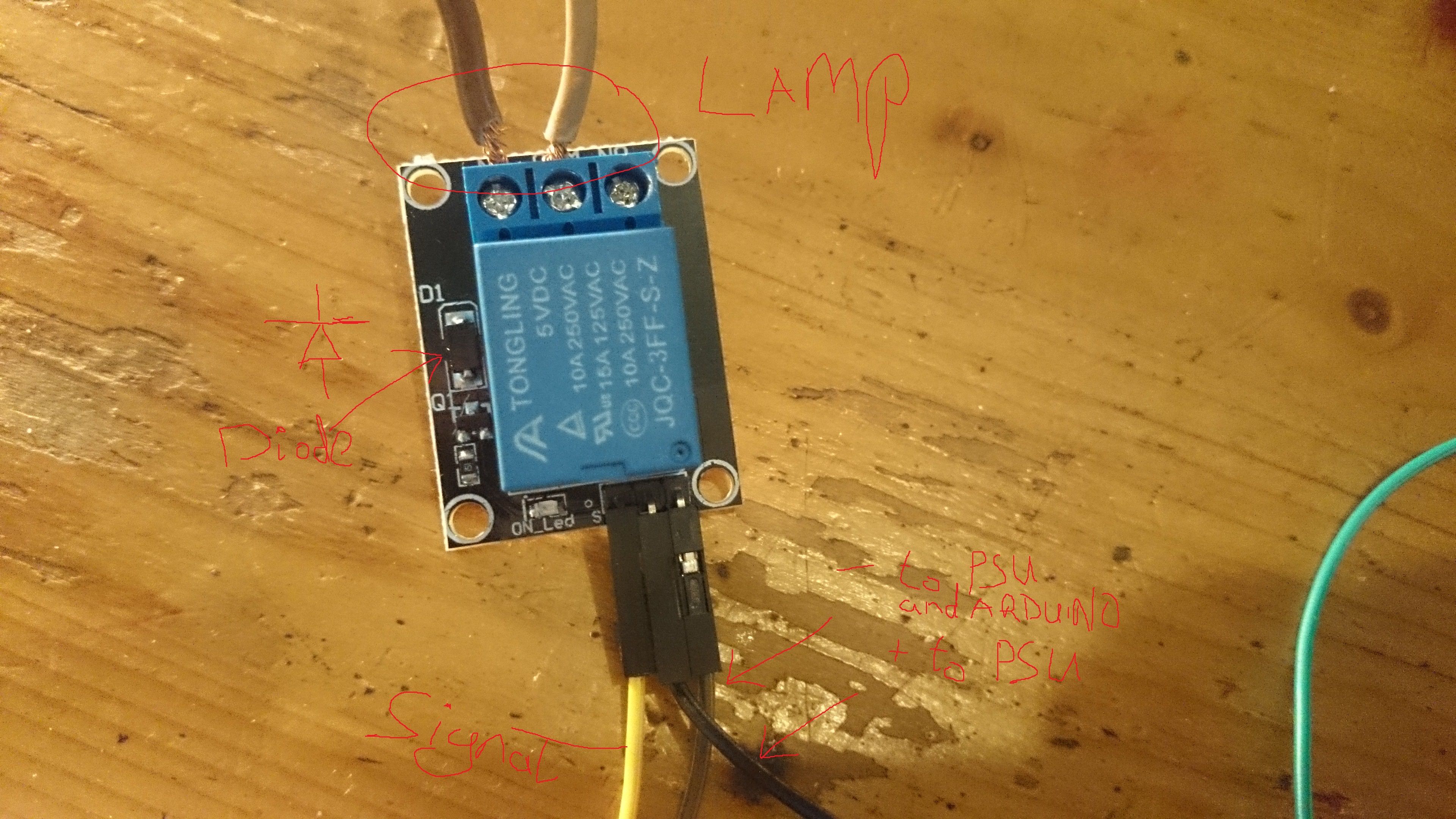

So my friend and i have been trying to create an incubator with an arduino; we got a DS18B20 temp sensor, AMT1001 sensor for humidity and a LCD to display both values. A button was even added to display the time elapsed.
Once we've got those working, we started to hook up a Tongling Relay that switched a lamp on when the temperature is below 37.5 C...
The setup works fine for a while, until at some random point in the switching process it simply fails and the screen is all corrupted. Showing weird characters. Once you reset it, it's working fine again. We have no idea why this happens and even tried it with a 5v and a 12v adapter because we thought it might've been an issue with the power. Sadly that didn't work. Maybe we need to add a capacitor somewhere so the spike in the switching of the relays doesn't screw up the LCD ? Wouldn't know where exactly to put it though.

This is a common problem. Some ElectroMagnetic Interference.
How is this all packaged? Where is system ground? Are the relay(s) optically isolated?

Have you tried running the sketch with the relay disconnected? Then with the lamp load disconnected?

Holy crap. I mean, i have honestly no idea where to start or stop with that. Most of the wiring is done by either soldering or the standard wires that you put on a breadboard; there's not that much power going through it but considering the system is not earthed through the power plugs, i guess that's a start?
Both of them are type C plugs (a 5v USB plug -> arduino and a 12v center positive Adapter -> Breadboard powersupply). How would you recommend grounding an arduino where the plugs are Type C and (this house has no proper ground other than in the kitchen, i believe)?
@aarg
"Have you tried running the sketch with the relay disconnected?"
Yes, with the whole relay disconnected from the whole system it works fine, as soon as the relay gets connected and it starts switching is when the problems occur.
"Then with the lamp load disconnected?"
No, I haven't actually. Sounds like another thing to test, though considering it's on a different circuit, i doubt it's gonna change much?

@aarg
So, just tested it and it looks like it works fine with the lamp DISCONNECTED...
Does that mean that the relay is bad or is there another explanation?
Waswat:
That doubt is not as great as the doubt about why it fails. You don't have anything to lose by trying it. It will help narrow it down to the relay circuit or else load.

Looks like it was fixed by using a 12v lamp rather than the usual 220v; still a bit of an issue as it's gonna be more difficult to heat up with a lower voltage for an incubator but i'll see what i can do with it.
