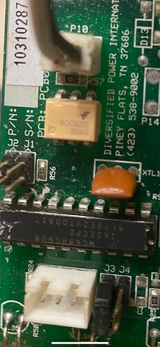

After looking around, I am pretty sure that the 48vdc from the battery pack is what powers up the PCB. Once powered up by the 48vdc from the pack, it then “senses” whether or not the charger should turn on the transformer and produce dc voltage through the PCB. There are two sealed potentiometers on the PCB that I assume adjust the voltage and amps at which the charger turns on and off and maybe how many amps it produces for a trickle charge when the battery pack is close to charged? Here is a better pic of the PCB.
There are only 3 components really. The relay (which I think is indeed a safety of some kind though I don’t know how it works), the transformer, and one single PCB which is pictures below:

The relay has a 120V coil. One side looks to be connected to the hot wire (black) at the relay itself, the other side likely goes to the two-pin connector labeled P10 on the circuit board. Near this connector is a six-pin DIP packaged chip, can't quite make out the numbers, but could be an opto-coupler used to switch the relay coil.
The relay wiring is shown in some of the manuals, but can't find any schematics for the circuit board using google.
The six pin dip chip says “MOC3Q12” under that it says “904Q”

An MOC3012 is a triac output optocoupler, which would be suitable for controlling the relay coil. 904Q is possibly a data code.
Can you explain how it works. The opto coupler activates the relay which cuts the main power off? How does the optocoupler “know” when to do this?

The large chip with the sticker labeled DP4814A8/A01R60 is likely a microprocessor, googling the number shows some reference to that as a software version number. The manufacturer's website has a very similar picture on their replacement board page, but no actual listing for the 48 volt version. https://www.dpipower.com/replacement-parts/controller-boards.html?product_list_limit=all
This is what is under the sticker. This I am assuming is the actual chip. I figure that the company loads there “code” on to this chip and the identifying number you are talking about is to identify what version of code is uploaded? Maybe for differing voltage chargers? I am completely guessing here.
So, the micro processor is getting information from some PCB component as to how many volts the battery pack has. If it needs to turn the charger off because the pack is at full charge, it sends a signal to the optocoupler, which then sends voltage to that relay? This cuts the main ac power off to the transformer?

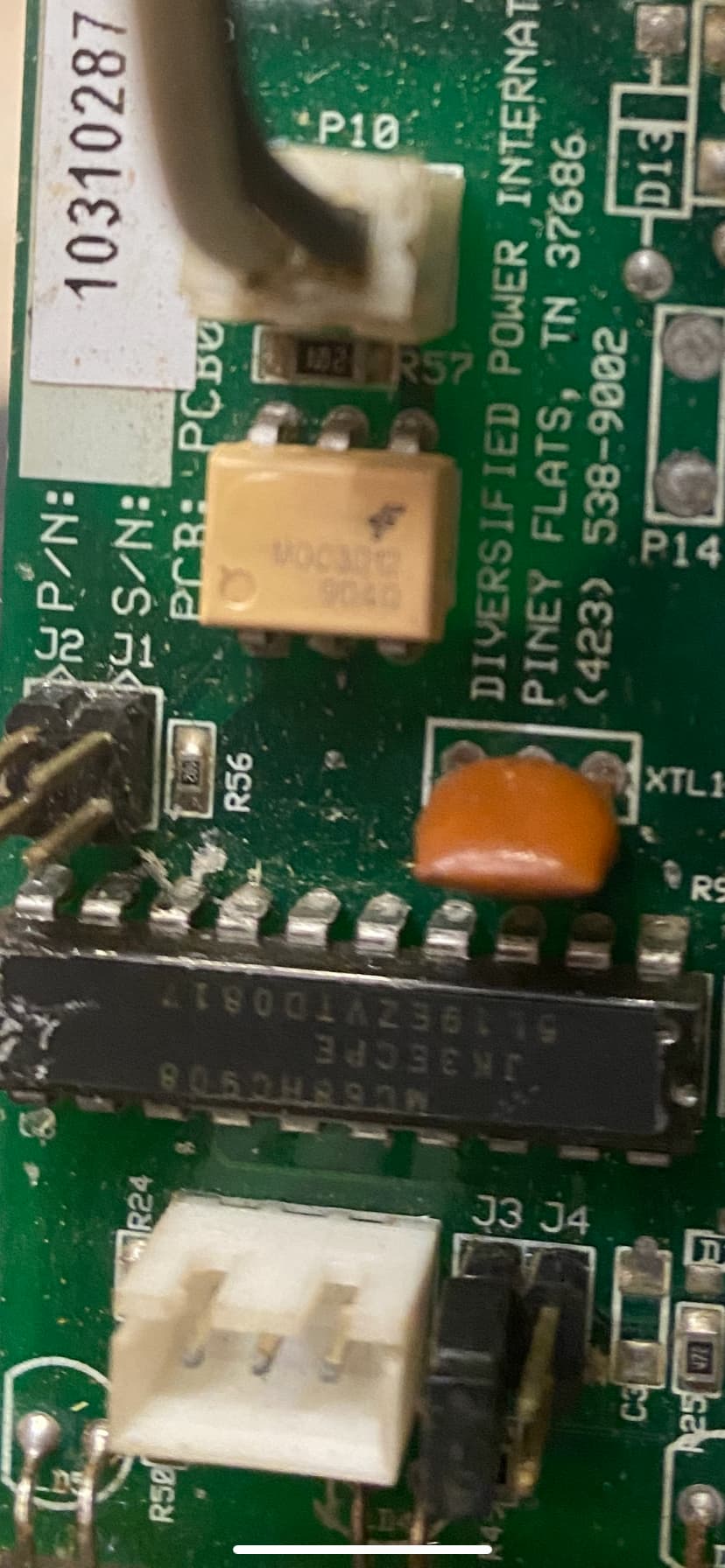

Edit: here is what is on the chip you are referring to and in the picture in this post:
mc68hc908
MC68HC908 is a microcontroller, basically works the same way as the processor in an arduino. No telling exactly how the rest of the boards works.
If it is non-operational, the first thing would be to make sure you are getting a good connection to the battery, and that the board was getting power to the electronics. The processor Vcc is a maximum of 6V, so there would need to be a voltage regulator somewhere on the board. Be careful if you decide to start measuring things, DO NOT plug the charger into 120V, that should not be necessary since the electronics appear to be run off the battery. 48V is getting high enough to be a shock hazard, and accidentally shorting the battery will destroy things (a 12V car battery easily supplies enough current to weld metal parts together).
