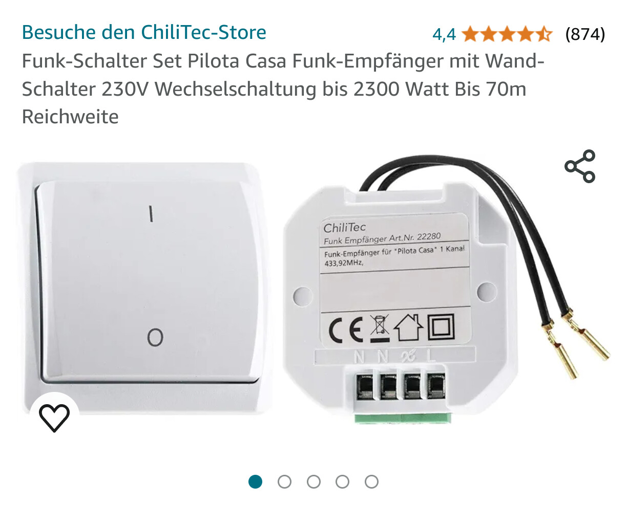

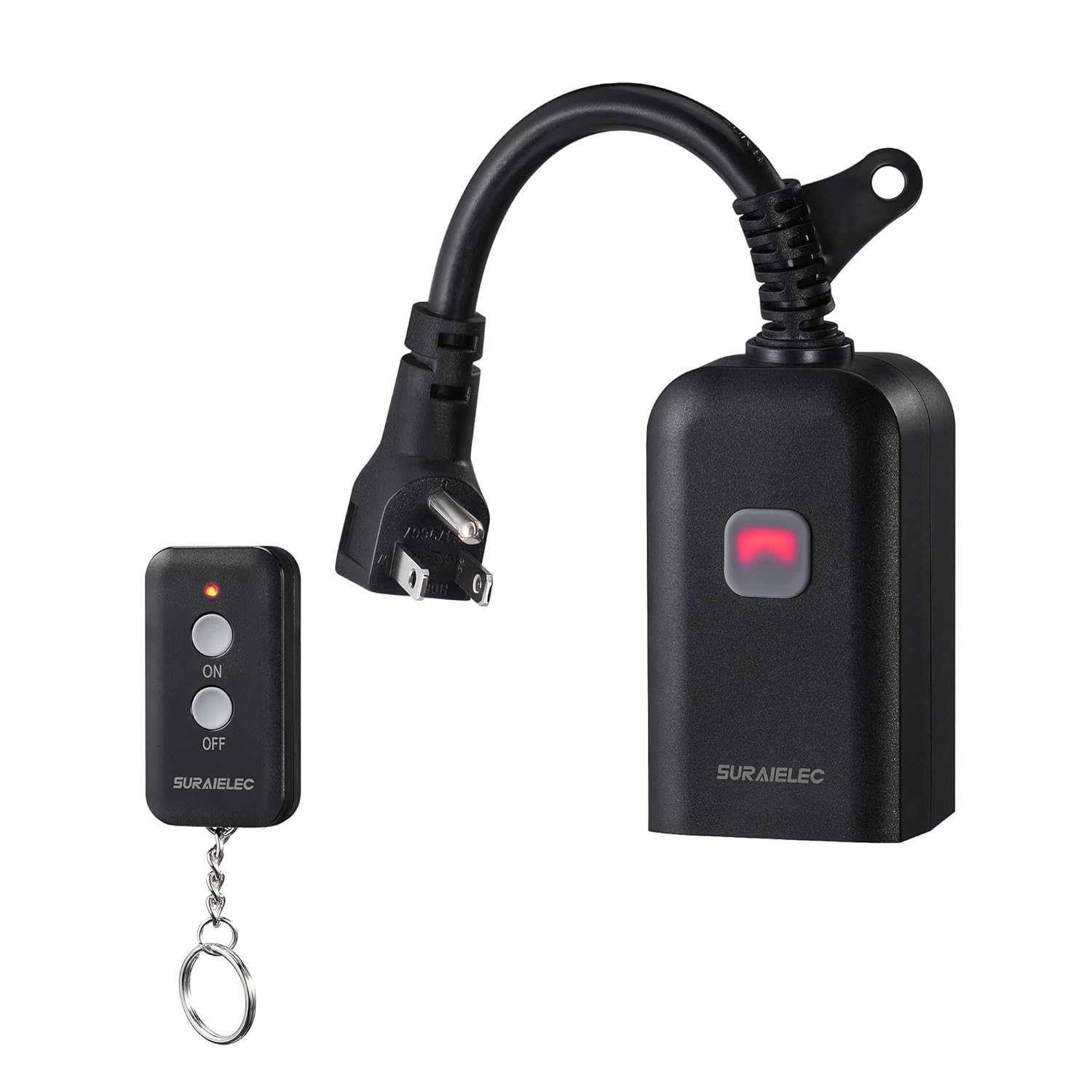

I thought of something likes this
Good.
I't a hit or miss without knowing actual transmitter/receiver. Not probably but certainly possibly, it can even use rolling code and then you are out of luck for sure.
