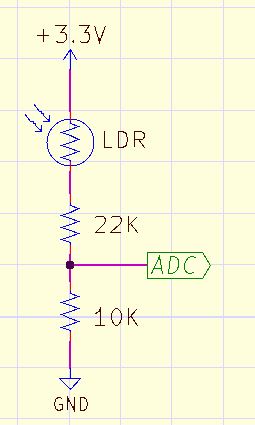

yes, this ones, I wanted to use as a voltage devider, from 3.3V to 0,9V. Wanna use it for an AnalogRead. But the 10K ones, for an PullUp. But, as @paulpaulson said, I should use the internal pullups :smiley:

it is like this. The AnalogRead from the ESP8266 accepts only a maximum Voltage of 1V. Therefore, I hade to devide the voltage :smiley:
Please forget my first shematic, look again here...
Look at the Analog pin of the Wemos D1 ESP8266 module: https://user-images.githubusercontent.com/53401742/71557972-7db54b80-2a13-11ea-9179-e96319fe7f2b.jpg for example values of the voltage divider.
You may also notice that this scheme means that the voltage divider goes after the connected device (LDR in your case) .

This will work
LDR_d
  • If you redraw this you will see GPIO15 is shorted to GND.
  • GPIO02 is connected to 3v3
  • 270R/100R voltage divider gives .9v to the LDR/10k voltage divider. :grimacing:
  • .9v / 100R = 9mA thru the 100R resistor.

Anything should work fine. While your voltage divider resistors are of unusually low values, their power dissipation is still quite low (3.3V/370ohm = ~9ma. 9mA through a 270ohm resistor is 0.02W, so even those itty-bitty 1/16W 0402 resistors would be OK.
