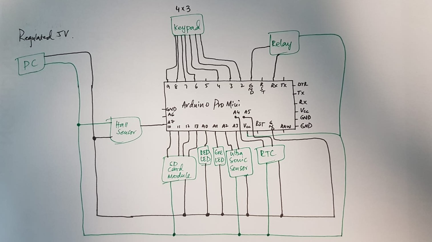

Hi everyone,
I am almost at the final step of my project and facing an issue that I need to discuss here. Attached is the schematic of my project to this message. I am using a Pro Mini 5V 16 MHz version, a 4x3 keypad, hall sensor, ultrasonic sensor, RTC, a memory card, one relay (that I am opting to replace with MOSFET), one red and one green LEDs are connected to the Arduino. As my system would be running on a battery, therefore, it was important for me to keep the current as low as possible. Therefore, after the use, I bring the Arduino to deep sleep mode. The current measurements are given below. In all the cases given below the Arduino itself is in deep sleep mode.
Peripherals Ultrasonic sensor Hall Sensor sd card module RTC Relay Current (mA)
Case 1 OFF OFF OFF OFF OFF 4 mA
Case 2 ON OFF OFF OFF OFF 7 mA
Case 3 ON ON OFF OFF OFF 13 mA
Case 4 ON ON ON OFF OFF 14 mA
Case 5 ON ON ON ON OFF 19 mA
Case 6 ON ON ON ON ON 19 mA
When the Arduino wakes up and all other peripherals are in ON state the current goes to 31 mA. The ON and OFF state of peripherals means, when the Arduino was in deep sleep mode, I disconnected the peripherals one by one and measured the current. So, if I don't turn OFF anything, the minimum possible for me is 19 mA, if I turn off everything when the Arduino is in deep sleep mode, I can achieve up to 4 mA and that would great.
So, my question is would it be possible to turn OFF every peripheral when Arduino is in deep sleep mode, and when it wakes up all the peripherals should wake up, too?
I am planning to use a MOSFET as a switch and before going to deep sleep mode, I disconnect the GND of all the devices through the MOSFET, and when wake up connects them back. Or is there another better way to do all this?
I am also planning to remove the power LED from the RTC and the Arduino and see how much would it reduce, I don't know but I think it won't be so much. I can not remove the regulator from the Arduino as I would be providing it with an unregulated voltage from the battery pack.
Any suggestions, please? Thank you
Post a real schematic please. And links to specs of all components/modules.
@Paul, I sure will do that tomorrow first thing in the morning.

@PaulRB, attached is the complete schematic and the components I used are given below.
  1. Ultrasonic Sensor HC-SR04
  2. Hall Sensor (https:://docs.rs-online.com/e64f/0900766b8106a158.pdf), I am using the UA package.
  3. DS3231 real-time clock
  4. 2 relay module optocoupler (On your suggestion, I would change it to a MOSFET)
  5. Keypad 4x3
  6. Micro SD card module bought it on Amazon, the link is given: (https://www.amazon.de/dp/B077MB17JB/ref=sspa_dk_detail_0?pd_rd_i=B06X1DX5WS&pd_rd_w=GPci7&pf_rd_p=907efdef-64f0-4d54-bac1-a1aa35942c8f&pd_rd_wg=3OT9I&pf_rd_r=Z22CH21TNEPMZPA97BB5&pd_rd_r=08f26063-8142-4d07-b9ce-50bfeb4c23fb&spLa=ZW5jcnlwdGVkUXVhbGlmaWVyPUFZTjM4MTFXQUNBS00mZW5jcnlwdGVkSWQ9QTA0MTcwMTYzNkRRN1ZWNlZTODJWJmVuY3J5cHRlZEFkSWQ9QTAzMzE2NTEzREIwWUNZSDI5UDhYJndpZGdldE5hbWU9c3BfZGV0YWlsX3RoZW1hdGljJmFjdGlvbj1jbGlja1JlZGlyZWN0JmRvTm90TG9nQ2xpY2s9dHJ1ZQ&th=1)
PaulRB:
Does the keypad library have a begin() method? Maybe call that again when waking from sleep.
No, there is not begin() for the keypad. I am using <Keypad.h> library. Before setup(), I am doing this:

You highlighted one thing that if the keypad had begin() method I should call it again, so, I wanna if we have a begin() for components, do we need to call them all the time after the Arduino wakes up? For instance, the RTC I am using has an rtc.begin(), and similarly, the sd card has initialization in the setup, so right now when I put the Arduino to sleep and wakes it up, I don't call their begin and they are still working. Or we only call the begin method when the power is cut down to those components?
Looking at the standard Arduino keypad library code, it sets pin modes and output levels explicitly for each pin, each time it scans the keypad. So you don't need to do anything with pin 2 on waking. I should say that reading the code inside a library to see how it works can be a dangerous thing. Maybe one day the library code will be changed, and what I said will no longer be true, and if you then re-upload your code after that, it could stop working. So it's best to avoid reading library code and making assumptions that it will never change. But in this case, I can't see another way.
Calling a library's begin() function after waking the Arduino is not normally neccessary. But if you put the component to sleep, it might be neccessary when you wake it. There is no simple yes/no answer. You have to learn about each component and it's library to figure out what must be done, if anything, when you wake it.
For the hall sensor, you cannot put the component into a sleep mode. The only thing to do is power it down. It requires only 14mA maximum, so you can power it from an arduino pin. That means you will need an analog input pin and a digital output pin for the sensor. You can power down the sensor by writing LOW to the digital output pin and power it up by writing HIGH. After powering up, you should have a short delay, 32us, before you read the analog pin. You may need to discard the first analog reading and take a second reading.
