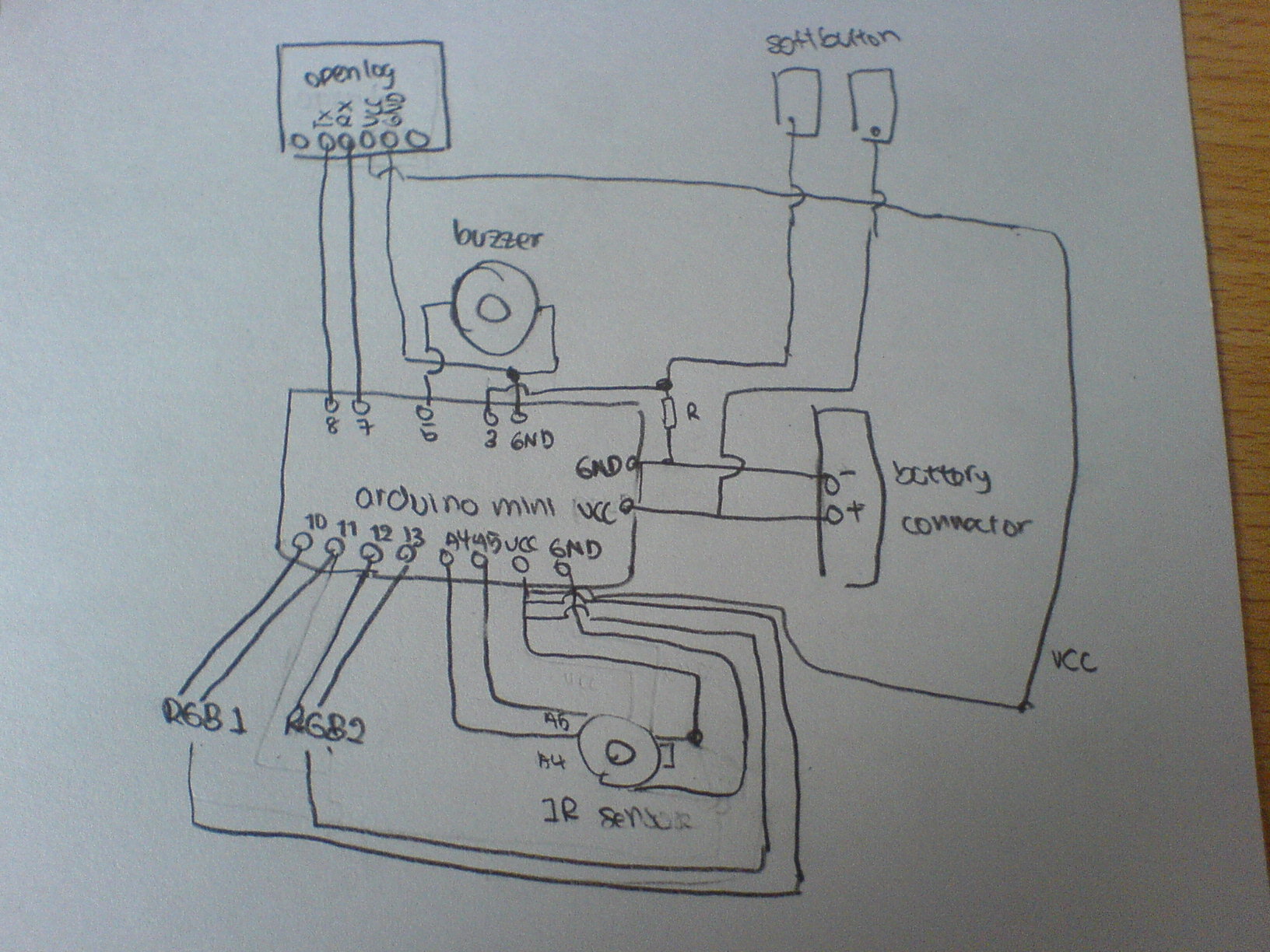

I will get working on the schematic right away
Please excuse my bad drawing skill.
Don't you have current limiting resistors in the front of the RGB leds? What what are the two boxes in the top right corner? I can't read the text above them.
"soft button"
I have newer used buzzers, but shouldn't you have a resistor in the front of it also?
I am currently using the RGB from the lilypad series (http://www.sparkfun.com/products/8467).
The soft button made up of two layers of conductive fabric separated by a layer of sponge.
One side is connected to ground and input. The another is connected to VCC.
How can I make one that produce LOW when it is press to be replace with this one ??
Are the resistors necessary ??? Will it help in reducing power consumption or does it provide more stability ?
You absolutely need to add the resistors. Check the shematic from the page you linked. It shows how to wire the resistors. Without the resistors the leds draw to much current. It may damage both the Arduino and the leds. And yes, the resistors will reduce the power consumption.
Check also the buzzer's specs. It may need a resistor as well. Btw, do you know how much current the openlog in your diagram draws while idling?
Wire the other end of the button into the GND pin. Remove the pull down resistor R from your diagram and enable the Arduino's internal pull up, http://www.arduino.cc/en/Tutorial/DigitalPins. Or if you want use an external pull up, connect it into the Arduino's Vcc pin.
And the most important thing: What is the battery's voltage? Is it 3.3V? If it is higher than that, you need to connect it into the RAW pin instead of Vcc.
Btw, the schematic on the Sparkfun's page is for 5V. You need the calculate resistor values for 3.3V yourself.
It is 3.7V and I totally forget about the RAW pin - -"
And I have no idea how much openlog (SparkFun OpenLog - DEV-13712 - SparkFun Electronics) consume while idling.
I'll take that back. I looked at the picture on the Sparfun's webpage again and noticed the leds on the pcb already seem to have the resistors in front of them. However, this leads to an other problem: If the resistors are rated for 5V, then the led's wont be very bright if you power them from 3.3V.
