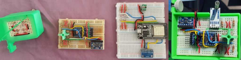

Here is a screenshot of my three iterations of this project:

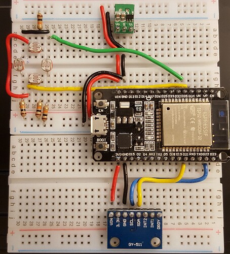

The tolerance of the LDRs is inconsequential. At most the error would only amount to a fraction of a degree. The tolerance they are referring to is the dead zone that once reached will stop the motion of the associated servo. By rotating the tracker 45 degrees (as I suggested in my previous post) you only need to measure the difference between the top and bottom LDRs to control the vertical (elevation) motion and likewise, only the left and right LDRs to control the azimuth of the tracker. When there's a difference, move the servo until it reaches the appropriate dead zone, then stop. If you take it further, you can use the difference to control the speed so the tracker will slow as it approaches equilibrium between the 2 associated LDRs which should help reduce or eliminate the jitter as it reaches 0 difference.
The LDRs would be the simplest way to go. By wiring the top & bottom in series (same for the left & right) and measuring the junction voltage for 1/2 source using an analog input you only need to use 2 analog inputs to control the tracker, because when the tracker is aiming straight at the sun, their resistance will be equal resulting in a voltage of 1/2 the source at the junction, but be careful that their total resistance doesn't go so low as to short out the supply. If so, you can add 2 equal value resistors to eliminate the problem. ie res-LDR-LDR-res.

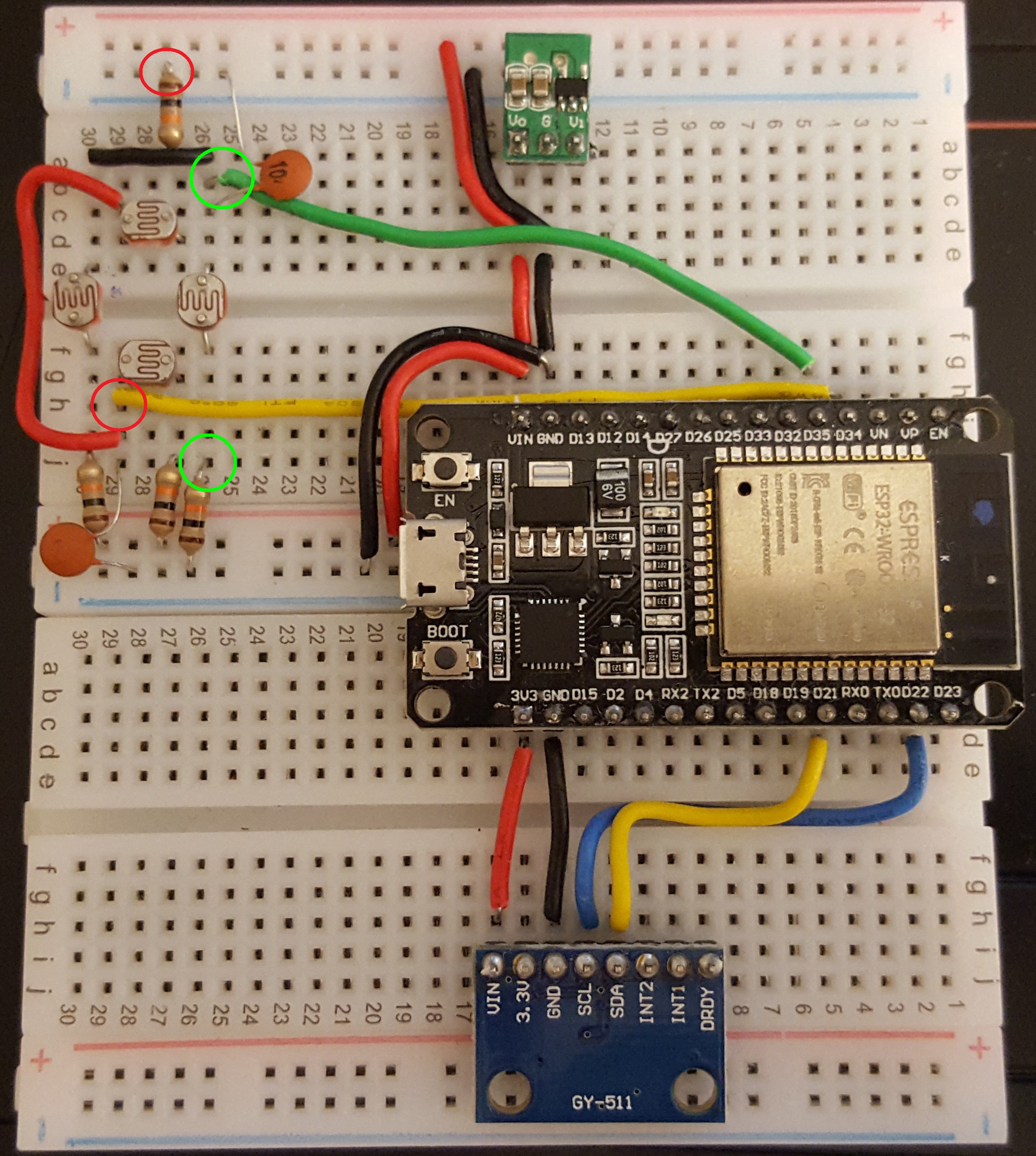

A breadboard produces a lot of noise, especially with A:D circuits. I found soldering my projects to a proto board increased stability. I use sockets for items like the ESP32.
I see what you are saying now.
So I should separate the two sets of photoresistors by rotating my light divider orientation 45 degrees and also the photoresistors?
That would also simplify the code.
I just wonder if both those motions of azimuth and elevation rotation can happen simultaneously with that orientation as the light balances it self out and the shadows disappear.
@Ken_F
Regarding the photoresistors in series and 2 analog inputs looks like a really nice and simpler concept.
Although I don't understand how I would short things out if I put them in series?
V=IR --> Resistance drops and I give the analog input pin too much current?

I made the voltage divider circuit.
I'm using 10kohm resistors before and after the photoresistors that are in series.
Can't seem to figure out why the output voltage from ESP32 Vin pin and GND reads out 4.63 volts after I plugged the ESP32 microusb port into the PC.
The chip on the top right side of the breadboard is a voltage step down converter that's supposed to drop down the input voltage to the ESP32 to 3.3V.
I am going to power it with a 6 volt solar panel.

I was wondering if my setup is correct for reducing noise based on other setups I've seen online?
I know breadboards versus pcb boards have more noise but I wanted avoid soldering so it's easier for others to make this circuit themselves.
I have capacitors going from the analog outputs to gnd of the circuit.
I measured my capacitors to be near 70 nF or .07 uF with the multimeter.
The results seem to be closer than before when I wasn't using capacitors.
I will try to multisample next.
In the screenshot below am I measuring analog output voltages at the correct locations circled in green and red?
This is the output I'm measuring for the elevation voltage:
2.19 volts
2051.00
2023.00
2037.00
2061.00
This is the output I'm measuring for the azimuth voltage:
1.5 volts
1625.00
1602.00
1599.00
1521.00
