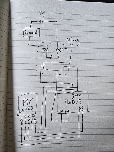

Hi
I'm a complete beginner with Arduino programming, so apologies in advance if anything below isn't clear. I'm trying to build a device for an automatic feeder that activates a solenoid via a relay every day at a specific time. It's battery powered, so I'm using a DS3231 RTC to wake it from a powered down state and trigger the relay, before going back to powered down.
I've put together the code below, and have managed to get the alarm to close the relay switch at the set time and activate the solenoid. However, instead of then opening the switch after a second, the relay stays closed and the solenoid activated.
My understanding is that it should return to line 90 after executing activateRelay.
Any help appreciated.

I don't see an obvious problem with the code, and suspect that the relay is the problem. Please post a link to the relay product page or data sheet.
To test program function, replace the relay with an LED in series with a resistor (e.g. 1K).

The LED stays on as well, so it looks like it's a problem in the code.

  attachInterrupt(digitalPinToInterrupt(2), activateRelay, LOW);
  Serial.flush();
  LowPower.powerDown(SLEEP_FOREVER, ADC_OFF, BOD_OFF);
  delay(300);
  Serial.println("Waking up");
  Serial.println("Deactivating");
  digitalWrite(relayPin, LOW);
  delay(300);
  detachInterrupt(digitalPinToInterrupt(2));
 void activateRelay(){
  digitalWrite(relayPin, HIGH);
  pinMode(wakeUpPin, INPUT_PULLUP);
  Serial.flush();
  delay(300);
  detachInterrupt(wakeUpPin);
Cycles on and off repeatedly, I should say.
With this setting, interrupts will keep firing as long as input pin 2 is LOW. Perhaps you should immediately reset the RTC alarm.
