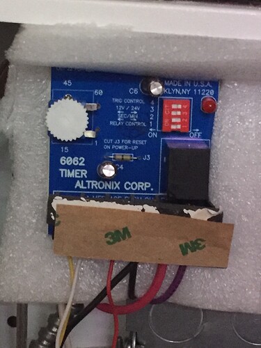

In the room there is a BIG RED BUTTON. When pushed, all the lights in the bathroom shut off, a disco ball and light come on and a song is played. It lasts for about 20 seconds then the regular lights come back on....
That is what is supposed to happen. :o
I was asked me to change the songs to go with the therme of the new install.....but.....when i changed the songs and replaced the mini cf, the BIG RED BUTTON didnt trigger the light/song change.
The only thing I did was pop out the mini CF , which contained 6 mp3s in 2 folders. i did'nt change the folders just simply replaced the mp3's with new songs. popped it back in and then the Big Red Button did not work, like its not hitting the relay to activate the arduino. or something...
The altronix timer has 4 dip switches. When I opened it up, all were to the left except the 3rd one down which was to the right.
When I switched the bottom dipswith to the left, it triggered the song and lights like it was supposed to when the BIG RED BUTTON was pushed. But only when i manually swithched the dip switch... so it was defintely reading the mini-cf card.

It sounds like to connection between the button and the 6062 came loose since you are not able to trigger the module by pressing the button. I'd start by checking those wires.

Thanks for the tip, I'll definately check that.
Would changing the songs on the cf card have anything to do with this?
I don't see how it could....

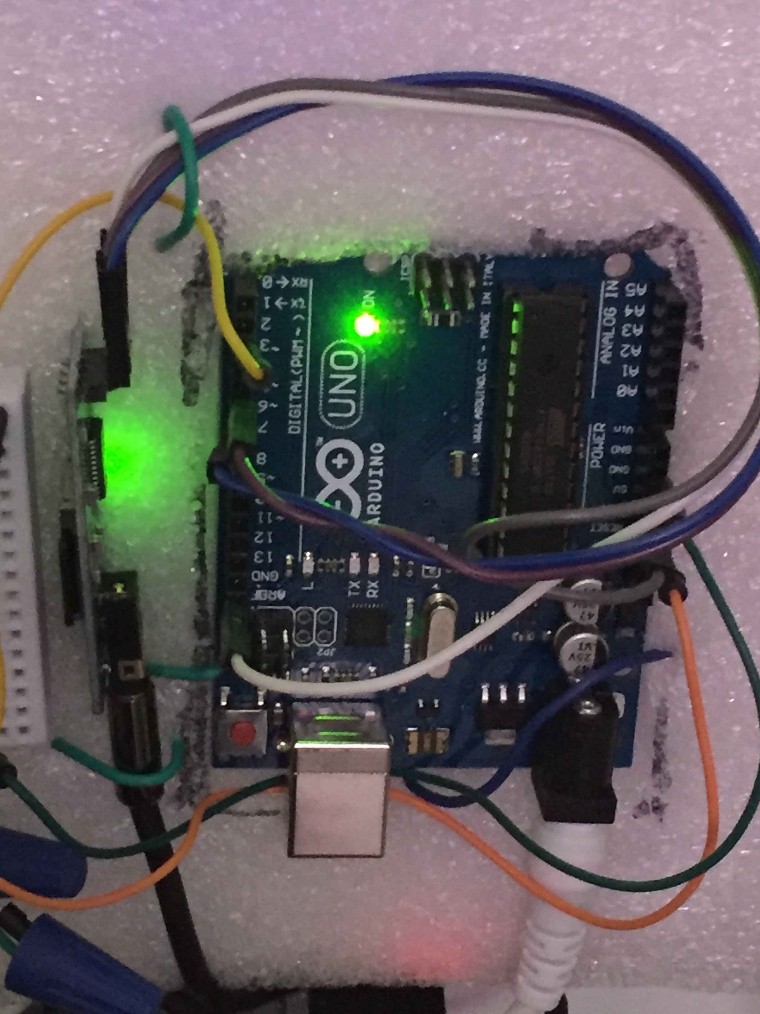

If the Styrofoam in the pictures is not special ESD foam, you may have zapped something with static electricity.

Another possibility is that you disturbed a wire when you removed the card. I see breadboard in your picture - it's not really intended for long term use and easily messed up if you bump it.
