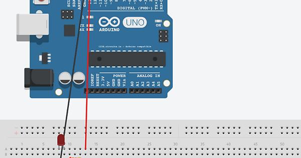

I tried setting up the circuit with the voltage dividers, but instead of 2.7k and 4.4k ohm resistors, I replaced them both with 1k resistors :stuck_out_tongue: (the only other resistors I have are 100, 10k, 470k and 10 million) and the exact same issue came up (reverse question marks)
Circuit:
Crappy drawing:
HC 06 Front and Back:

Where is the current limit resistor for the LED?

No offense, but those pictures are pretty bad (the first too at least). You should take new ones so that all the connections are easily seen and verified. Then post those pics.
Well, to be 100% honest, I don't know how you expect it. Considering none of the wire lengths are customizable (they all have headers and cutting them would defeat the purpose), they're inevitably going to be tangled up when I try to snap a picture of them. Also, the fact that they're long wires makes it hard for me to get any kind of good close up shot while still getting everything in the shot. I tried labeling this portion of the circuit but I don't know if you're going to find it any more useful
The Blink sketch works perfectly, so I know that the LED circuit isn't the source of the problem. The premise is the same as a Blink sketch. When I press the On Button, the app sends the string "2on" to the Arduino, which calls digitalWrite(ledblue,HIGH). When the Off button is pressed, the app sends "2off" to the module, which calls digitalWrite(led,LOW). It's something up with the Bluetooth module. For whatever reason, the Arduino isn't getting the correct string when either button is being pressed.

What did you find bad about the first image? It shows everything clearly, except whether OP mixed the LED's + and - pin. I don't want to be a smartass, I just don't understand...
Maybe my eyes are bad, but the connections on both the breadboard and Arduino were very difficult to verify without assumptions. It just wasn't clear. It has nothing to do with resolution, but more with composition.
