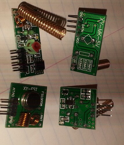

Hello,
I bought these a bunch 433mhz Receiver and Transmitter from ebay and setup an arduino Uno with the transmitter and my raspberry pi .
I was able to hookup the transmitter to the Arduino and the Receiver to the PI easily with information available online. I am able to send signals and receive them on my raspberry but the issue I am having is for every value sent once from my arduino, the raspberry seems to be detecting multiple values. I am not sure why this is happening. I have replaced 5 different transmitters and receivers, so I am not sure if it is a hardware issue.
I would appreciate some help/guidance with this.
I am using RFSniffer to detect the signals on my PI and this is what I see.
Received 1111
Received 1111

Also attaching the picture of the rf components, which seem to be very commonly used by a lot of projects online.
The RCswitch library is used for the simple remote controls. They use some kind of 3-state code. And it is repeated 10 to 20 times to increase the chance that it is received. Every receiver can handle those multiple transmissions.
The first detected transmission is often the second one, since the trailer of the first is needed to get into sync.
It is set with setRepeatTransmit(10); in RCSwitch.cpp. So the default is 10 times.
Does the Raspberry Pi have some timing during receiving ? I don't know how long the total of 10 transmissions is, perhaps half a second.

Thank you so much Peter_n. I was able reduce the repeats by adding the two lines before my send. I will give the radio head library a try. Here is my code, in case anyoneelse is following , its not complete by any means, it is just a start to my next step.
  mySwitch.enableTransmit(10);
  mySwitch.setPulseLength(183); //New Line
   mySwitch.setRepeatTransmit(4); //Fix for multiple repeats
