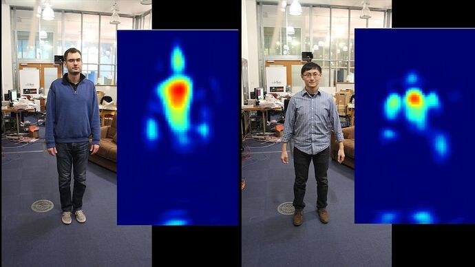

Basically they shoot Wi-Fi through the wall and can see people on the other side. Using software it looks similar to a heat map. Thinking of using the same technology to "see" water on the other side of ice and then using the speed of the wave to measure the distance(thickness) of ice

Google Scholar on the lead investigator leads to this patent application. It's apparently a phased array chirped radar with image processing back end enabling a laundry list of applications described so as to make it patent-able.
