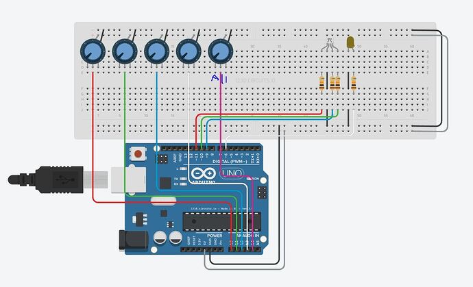

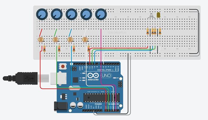

I have been trying to build a RGBW led controller that uses pots right now but i would like to move over to photoresistors for the project i have. I want to take the colors of light outside and reproduce them inside with white as well.
I got it to work with RGB, but when i went to add the White channel i broke it somehow. I dont know much about writing the code but i can read it. I would like to add a pot to control all channels as a dimmer as well.
Can someone help me with the code please. Here is the code i have and a layout of what i have so far

I worked on it some more and I found that you can't use names as I did for the different things, there is a system to naming the things that are connected. I rewrote the code and i came up with this. I still can't find out a way to get 'ALL' (The right most pot) to lower the values of the others (RGBW) equally like a normal dimmer without changing the colors produced. That is the part I need help with now, I have no clue what to do from this point.

You are going to want to adjust the value of outputValueRED, outputValueGREEN, outputValueBLUE, and outputValueWHITE according to the value of sensorValueALL. So from reading your code it appears that if analogRead(analogInPinALL) == 0 you want all those values to remain unchanged, if analogRead(analogInPinALL) == 1023 you want all those values to be set to 0. If analogRead(analogInPinALL) == 511 you would want them to be divided by two. This idea of analogOutPinALL is completely wrong, you don't do this with hardware, you do it with code. Once you understand that writing the code should be easy enough.
Now, after doing that you may find it's not quite so simple because the eye doesn't perceive light in a linear fashion. The jump in brightness between 1 and 2 is much larger than between 1022 and 1023. There is some good information on working around this available but get it working with a linear adjustment first before deciding if more complex code is required.
I you map the ALL reading to a value below 256, you can use it as the upper limit on the channels.
This should work

Thank you very much Whandall, I did not think of using the outputValueALL as a variable. And the Serial debug is a lot nicer than what I had. The AnalogOutPinALL = 3, that pot does not need a output pin for data, would it be good to remove that part or does the code need that assigned to something?
GuardianFox:
You can safely remove that, I just forgot it.
Is the effect now like you want to have it?
It does work as I was hoping thank you again. As a second project I'm glad there are people to help.
