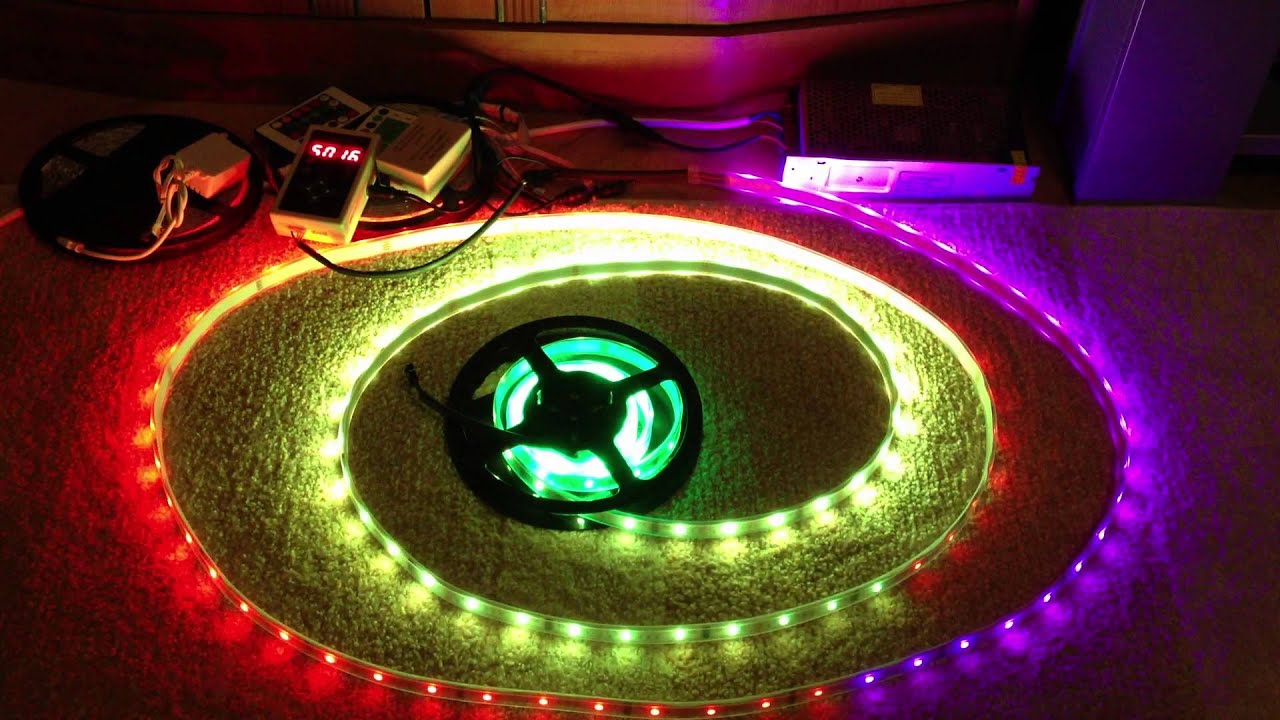

Im new to arduino and am looking at project using the led strips to make a light painting tool. This has the arduino code written and I get ask and get help on the site it needed. I have this other project where I would like to use either 1 x 3-5 meter led strip or maybe 2x back to back to go on a flag pole. I have seen things like what im after from maplin and other shops but dont think they are waterproof and they are locked with the patterns built in.
Here are 2 links with the kind of things I would like it to do.
Probably just have it on a random loop for the patterns and change this later when I know more about programming the arduino. Could any of you please point me in the right direction to start with this. The light painting tool uses a mega but im hoping my uno will be good enough for this. I will have to use an external power probably from a small 12 lead acid and use a dc dc 5 volt regulator.
As to what strip type I have not decided between the WS2812B or lpd8806
Many thanks

you can buy weather proof (not strictly waterproof) strips from uk ebay suppliers from between £10-£40 per metre depending on number of leds per metre. Cheapest are the 30 per metre going up to 144 per metre. The 5V power supply is also going to be a significant cost, these things draw a lot of current. An Arduino Uno/nano 3/pro micro/pro mini will be needed to control, there's no point getting a mega/due for this task.
I have not come accross lpd8806 but have used ws2812b with Arduino.

Hi Lee, there are a couple of Libraries that make using the ws2812b strips easier to write a script for. I have used the Adafruit Neopixel library. The other one is called FastLED . I've not tried that but it sounds similar. The Neopixel library download package includes some demo programs which may be all you need. You can take the "strand test" sketch and modify that for the effects you want.
Problem you may have is powering 3m of these things while camping. They need 5V supply and 3m @60 LEDs/m is over 10A!
Paul.
I have the adafruit lib but not really had a good look at it yet. The power is something I need to think about. When I say camping I mean caravan. Im thinking of using a 12V lead acid and a 12-5v converter at 10A, although finding one of that size is not easy unless you want it from China. Then have a solar cell to charge the battery during the day. If we are on a site with mains then just use a mains to 5V adapter.
