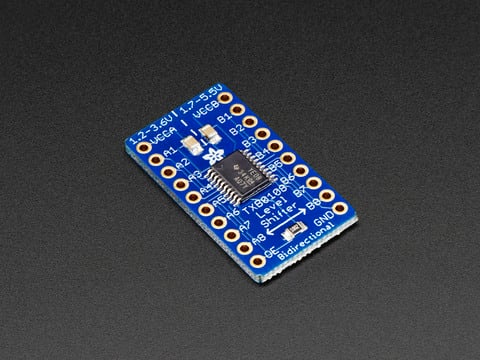

I would like to use 5V RGBW LED strips with Arduino nano 33 BT which IO pins are only 3.3V tolerant, so I would like to use level shifter (TXB0108). My question is, do I need those resistors (see attached image, please) ?

That Adafruit level shifter is massive overkill for the job - a 74HCT14 would do it perfectly for three channels, or even a 74HC04. :roll_eyes:
The question relating to the OP is - why do you imagine a level shifter would "protect" the LED strips? From what do you imagine the resistors are protecting? Yes, they are doing something, but do you actually know what it is? :astonished:

You need a proper level shiftier not the I2C one you have. That one is just on the edge of not working. It is nor fast enough to work reliably.
According to Adafruit, this one is not I2C one.
Which one do you recommend?

Read reply #5. :roll_eyes:
8-channel Bi-directional Logic Level Converter [TXB0108] : ID 395 : $7.95 : Adafruit Industries, Unique & fun DIY electronics and kits
Thank you.
Yes but it also,says
Since this chip is a special bi-directional level shifter it does not have strong output pins that can drive LEDs or long cables,
So I would not use that either.
Grumpy_Mike:
Yes but it also,saysSo I would not use that either.
I did notice that but in this guide Shifting Levels he used the same level shifter. Thats why I thought it could be ok.
Anyway, I already ordered DIL one so I will use that.
