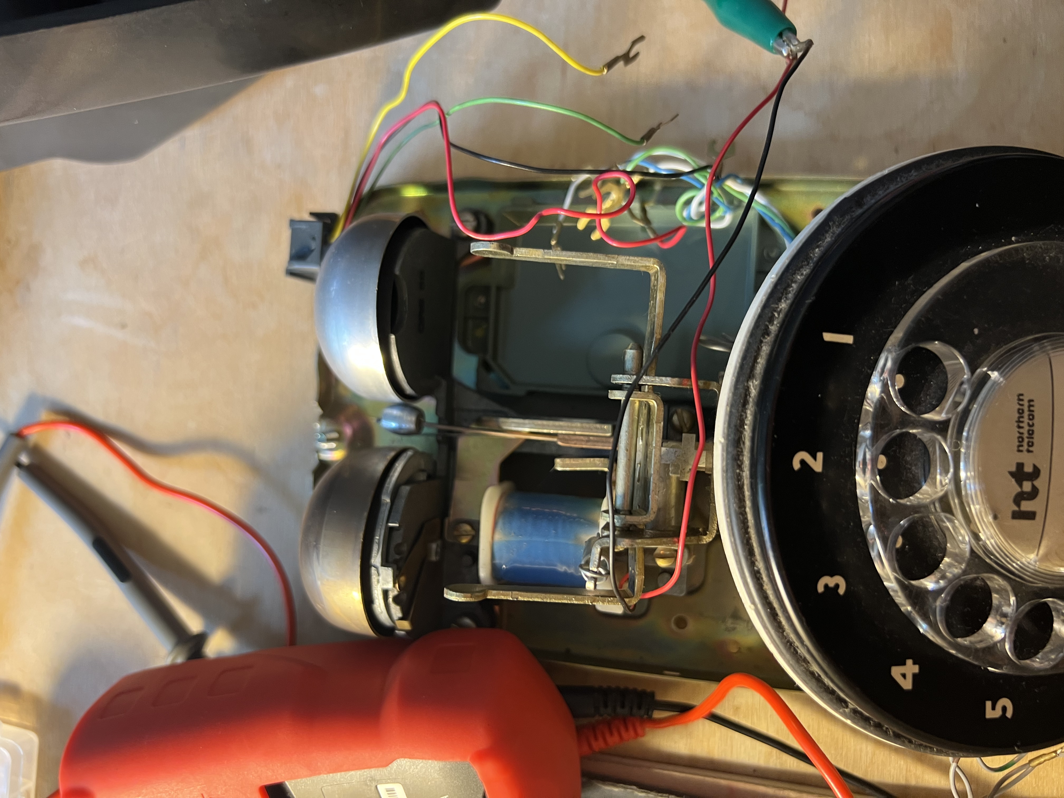

I got two phones so while I'm waiting on other parts I thought I'd try to see what the impedance of the coils are so that I can size my PSUs.
I thought i'd try measure them by seeing how the voltage of a sine wave drops over them at different frequencies using this method - https://www.youtube.com/watch?v=iQQe8uSZ8xc - and a USB oscilloscope that I have.
Strangely though I'm not getting any voltage drop across the coils.
i.e. when I connect the coil to the signal generator I get no change to the recorded sine wave. If iI connect a resistor across I do. this is the same at the various frequencies I've tried.
I'm wondering what obvious thing I'm missing? Any help much appreciated.
Edit -

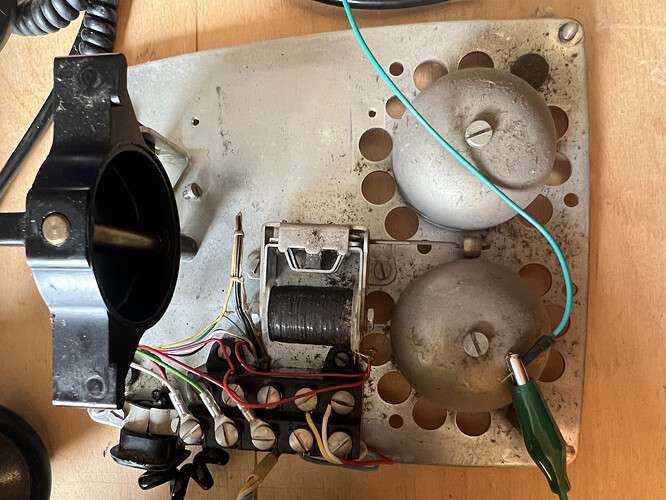

I should note that in the top picture I'm connecting across the two red wires connected to the coil beside the bell striker.
In the second picture I'm connecting to the red and black wires across the blue coild
Did you happen to measure the resistance across the coils?
1.8 kOhm
and 1.64 kOhm for the top and bottom respectively.
That is reasonable for use with 50-90 VAC ringing signal. Try it.
Am waiting on my H-Bridge as I've nothing that I can send that voltage across it with at the moment.
Was going to measure the impedence so I could get an idea of what amp 5V supply I need.
Will have another try with the scope. Maybe I was doing something wrong.
Get one or two door bell transformers. Try ringing with only one transformer. Then wire the transformer secondaries in series to get 48 VAC and try that.
I should have the other parts in the next few days so it doesn't make sense to get other parts.
I guess I'll just get the parts and try out some PSUs and see how they go - can't seem to measure the inductance.
Because the inductance is VERY high with the iron cores.
Does that mean it will take a lot of power to ring the bells then?
You can get a boost converter and a double pole double throw and generate the ring, that how it was in the CO (Central Office). Note these relays were designed for this type of application. Do not expect much below 50V.
The part missing on the top and the thing with all the screws on the bottom is the network I was referring to.
If you got across a phone line when it was ringing you got a good zap.
Consider the bells are an electric motor with the armature moving back and forth rather than a circular motion. The power required to ring the bells will be similar to powering a small electric motor with AC.

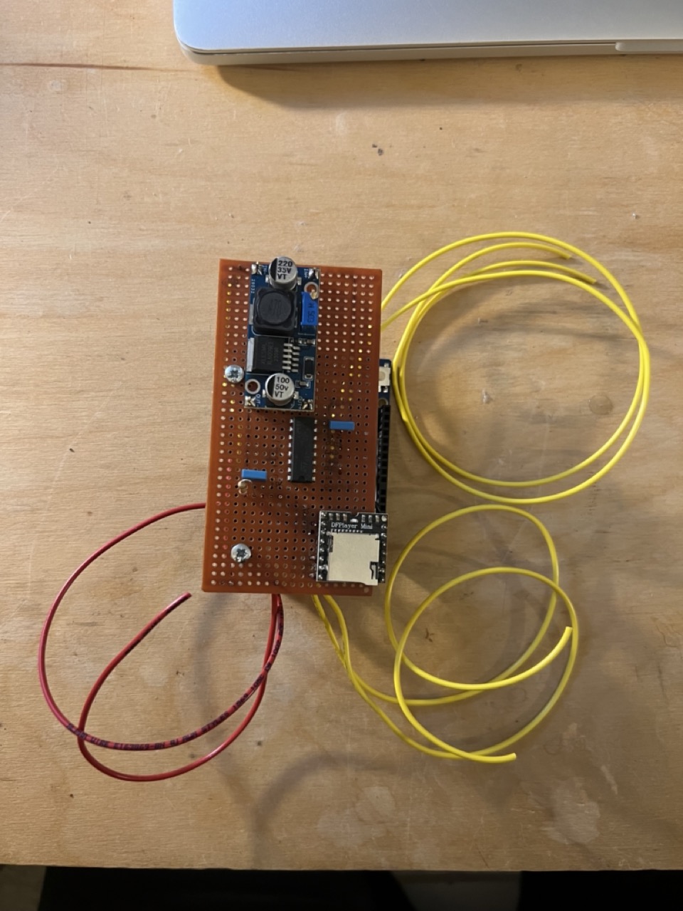

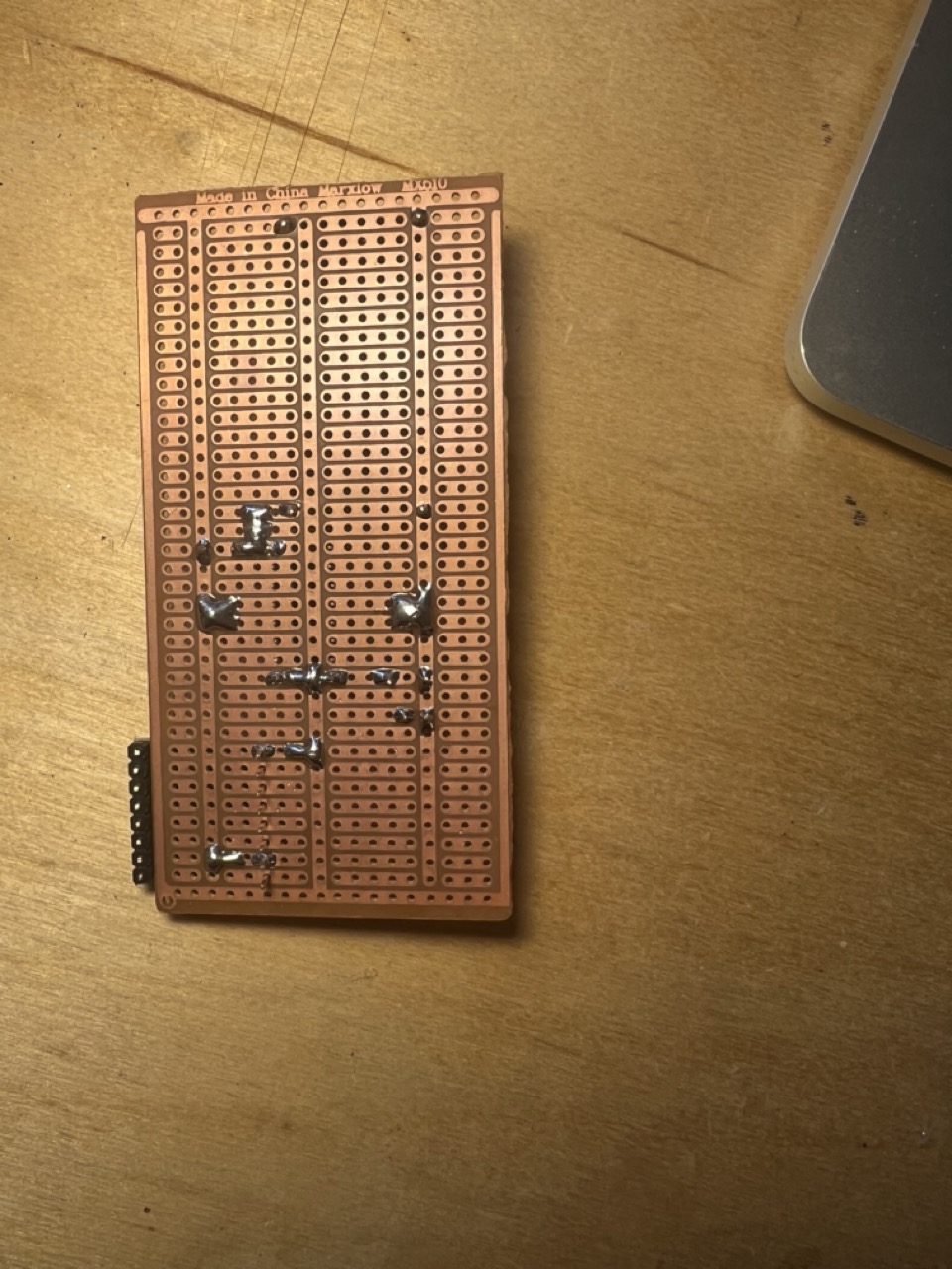

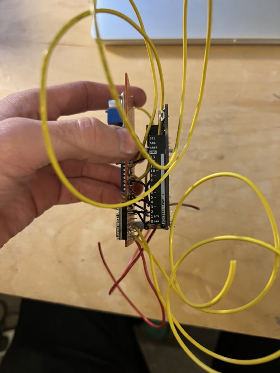

Here's some images of the ringing system and mp3 module for playing audio.
Is tested and working (can't upload video but it goes drrrring!)
Yellow cables for speaker and ringer, red cables for hook - power not hooked up here.
