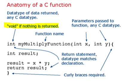

yes but it is there in that code but I don't know how to remove that error.
There is a 'return' statement but it doesn't specify any value.
yeah, I got it I just put return 0 now it's solved. thanks for the help guys.
FYI, removing compiler errors doesn't guarantee that a program will work correctly.
That is an incredibly foolish repair. If you don't need a return value from a function, declare it as void.
But, I suspect you are programming by trial and error. That will never work for a program of this complexity.
oho okay then how can I solve should i remove return?
I already told you in the last post.
Do you mean return void...? I don't understand.
I just got to a computer for a look at the code - it's incredibly foolish code, using inappropriate datatypes (double for Boolean is one example)
Have a look here, especially this:

Is it not a "user-defined" C function?
It is not a stand-alone function; it will do something if the formal parameters are received from the calling program.
