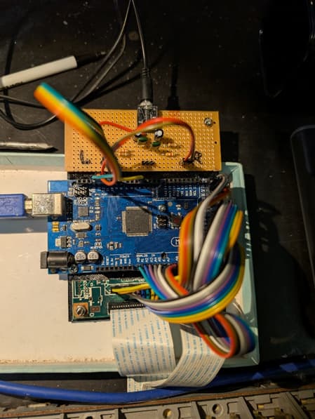

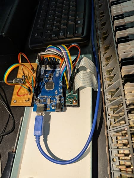

The old logic board is connected to the keyboard by a couple of flat flexible (FFC) cables. These are fragile and unobtainable, as are their sockets. Fortunately the logic board has holes for a couple of different types of keyboards which could be used for 0.1” pitch pins. I sawed the rest of the logic board off to retain the FFC sockets.
I 3D-printed a carrier to mount the Mega on the original standoffs inside the piano case. The audio output circuit is the same as the one described in Arduino-midi-sound-module, but split into two channels for stereo because the original piano had left and right speakers. Once wired up it looked like this. Did I say a lot of wires?

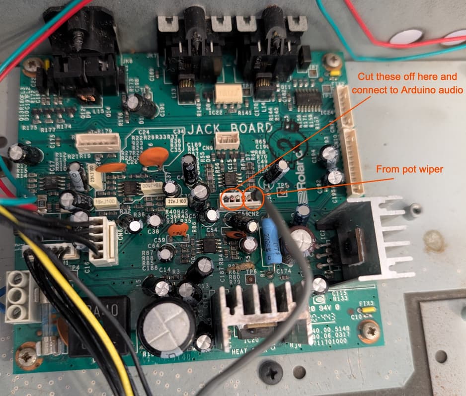

Connecting the audio signals
Since Roland pianos vary in their circuit boards there’s no guarantee this will reflect other models. The audio should always be able to be injected at the top of the existing volume control pot.

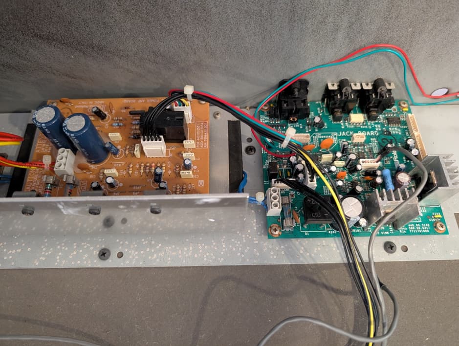

Here are the Roland’s amp/jack board and power supply/power amp board.
The volume pot connects to this connector on the jack board. Injecting a 1kHz square wave from a scope produced a loud squawk when connected to the top of the pot. Cutting off these wires and connecting to the Mega’s audio circuit completed the audio section.
There will also likely be a regulated 5V supply somewhere on the Roland’s amp board, but I’m not using that to power the Arduino as it is not recommended to drive the 5V pin directly. To be safe I’ll use a mains powered USB charger connected to the switched mains on the Roland’s power transformer, keeping all the mains stuff covered and out of the way.
