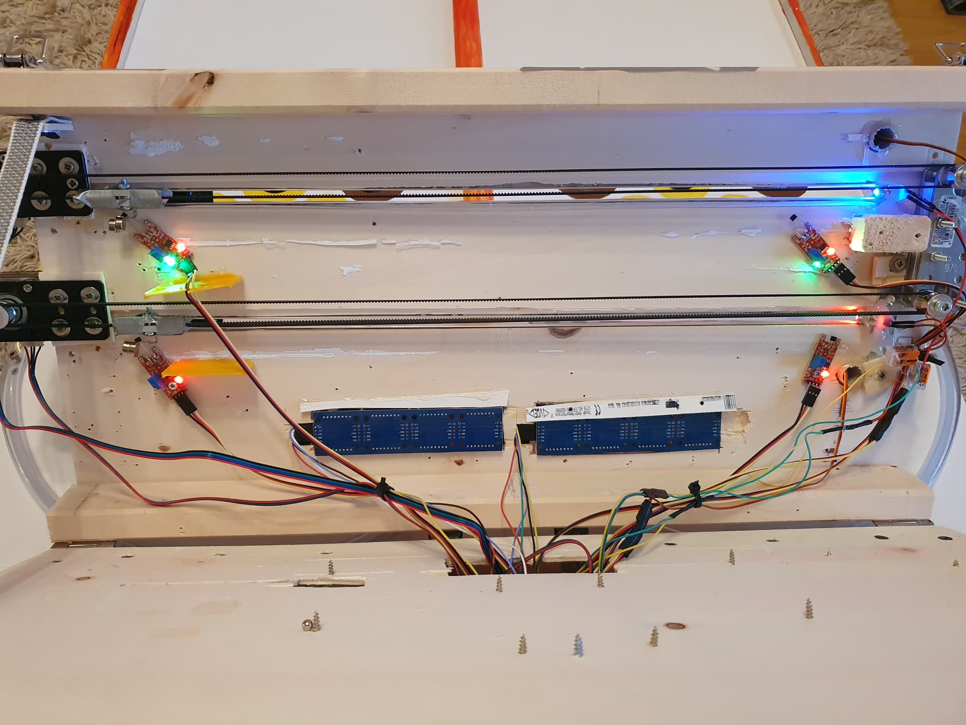

In my version, cars drive instead of horses run. The brown holes give one point, the yellow two, the red three and the blue four. For each point, your car moves a distance X forward and whoever reaches the finish line first is the winner. In addition, the points scored and the total score are also displayed via LED matrix. This also shows a few smaller simple animations and smileys, etc. Thanks to the Parola library, the panels are defined with two zones each, which can be addressed separately (total points on the left, current hit on the right).

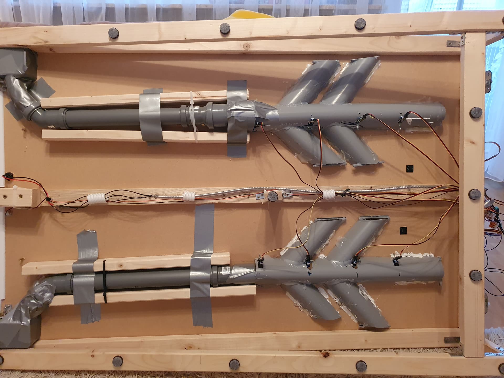

Which hole has been hit is detected by a total of 4 centrally placed optical sensors (KY-033) and the cars move by means of two Nema 17 motors with TB6600 motor drivers and two toothed belts. The substructure is a mixture of sawn-to-size rain gutters and pipes made of plastic.
A total of 4 Hall sensors determine whether the start or finish line has been reached. For this purpose, a few neodymium magnets are attached to the suspension of the cars. There are also a few LEDs and two flashing beacons that visually indicate when the finish line has been reached. After the end of the game and a short pause (for the obligatory award ceremony and tribute to the proud winner), the cars drive back on their own to the starting position for the next race.
The whole game measures 1.20 m x 0.80 m, as a smaller playing surface would somehow have spoiled the fun. Of course, this size is not quite compatible with a living room - but what did that matter to the enthusiastic hobbyist before :smiley:
The tracks are completely separated from each other in terms of electronics, i.e. two Arduino Nanos are installed - one for the right track, one for the left track. I solved the communication between the two sides via the wire library, with one Arduino acting as the master and the other as the slave, i.e. communication only takes place in one direction. So that the slave can also send back information, there is an extra pin as a link in the other direction... but it cannot transfer more than 0 or 1. There is only one sketch, the status (master/slave) of the respective Arduino is defined during compilation via a #define.
The power source is a 60W, 12V and 5A power supply. I have installed a switch at the positive pole so that you can easily switch the whole thing on and off. There is also a reset button that can be used to restart the game at any time.

Interior from the side
Interior from above
A tangle of cables in a confined space
Substructure
