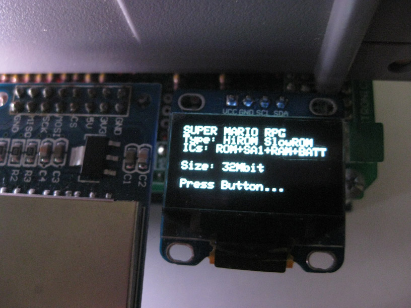

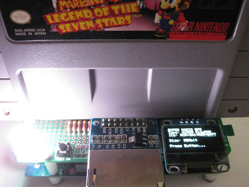

I managed to dump the SA-1 cart.
Wow - congratulations once again! :o There are not many solutions out there that support all the enhancement chips... :slight_smile:
skaman:
The CIC-SA1 connection is a bit hit-or-miss right now. Most of the time it doesn't connect but it will eventually work. I think I have to tweak the reset timings to get it working more consistently.

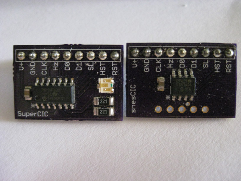

Some notes on the CIC stuff.
The most compatible version of the lock seems to be the snesCIC. I've been getting the best results using the snescic-lock-resync version. Get the ASM & HEX here: sd2snes/cic at develop · mrehkopf/sd2snes · GitHub
;   snesCIC LOCK 12F629
;   pin configuration: (cartridge slot pin) [original 18-pin SMD lock CIC pin]
;                       ,---_---.
;      +5V (27,58) [18] |1     8| GND (5,36) [9]
;      CIC clk (56) [7] |2     7| CIC data i/o 0 (55) [1]
;   host reset out [10] |3     6| CIC data i/o 1 (24) [2]
; CIC lock reset in [8] |4     5| CIC slave reset out (25) [11]
You wire up the snesCIC to the Cart Pins 24, 25, 55, 56. Connect CIC Pin 2 and Cart Pin 56 both to the clock generator outputting 3.072MHz. I also connected Host Reset (CIC Pin 3) and CIC Lock Reset (CIC Pin 4) to available pins on the Mega 2560.
The snesCIC has specific timing built into the code for the CIC LOCK-KEY to work. We need to set up our code to make sure the LOCK-KEY works right. Since the snesCIC has the correct timing, we need to trigger the code at the right time using the CIC Lock Reset. When CIC Lock Reset is HIGH then it is in reset, when LOW it is running the CIC code.
In our Arduino setup(), we immediately set CIC Lock Reset HIGH otherwise the LOCK-KEY communication may fail. Pulling CIC Lock Reset HIGH gives us time to get everything else that is connected to the Arduino up and running before trying the CIC handshake. We let most everything initialize in setup() then we set CIC Lock Reset LOW to start the CIC code and hopefully get a valid connection to the cart.
After making the changes to setup(), the SA-1 carts get recognized most of the time now. For when the cart is not recognized, I added a soft_Reset() "jmp 0" to reset the reader and start over. I've dumped all of my SA-1 carts except for one problem cart, PGA European Tour. I don't know what is different about the cart but it only spits out 0x17s right now.

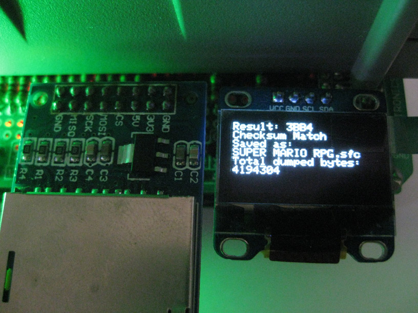

EDIT: I managed to get the problematic PGA European Tour to dump. I put the cart in the SNES and let it run for a little bit then moved it over to the reader and dumped it. I'm still not sure what makes this cart fail. I'll have to look at the SA-1 registers to see what is there.
Success!

For anyone planning on adding SA-1 support to their reader, the snescic-lock-resync is definitely the best version to use. Don't bother with the SuperCIC as it doesn't recognize the SA-1 carts as reliably as the snesCIC resync version.
Using my reader, I dumped a new version of an SA-1 cart, PGA Tour 96 (U). The cart that I dumped is Revision 1.1 with ROM chip "SNS-A3GE-1". The previous known version is Revision 1.0 with chip "SNS-A3GE-0" (I dumped a copy of that one too). I submitted the new dump to No-Intro and GoodTools so it will eventually be available for anyone that cares about this type of stuff.

The Adafruit Clock Generator is needed for SPC7110 and SA-1 carts. The clock generator uses CLK0 to generate the 21.477272MHz master clock signal that is connected to Pin 1 of the cart connector. CLK2 outputs the 3.072MHz CIC clock signal which is wired to the CIC clk in on the snesCIC/SuperCIC chip.
The snesCIC/SuperCIC has the CIC host reset and CIC lock reset connected to Arduino pins 6 & 7, respectively (although I haven't implemented any code for the CIC host reset in this version). The remaining CIC connections are wired to the appropriate pins on the cart connector.
As of right now, the snesCIC/SuperCIC is only really necessary for SA-1 carts. There's a possibility that the Nintendo Power (SF Memory Cassette) carts need the CIC but my best results with my current NP code is without the CIC (and clock).
One last item, some of these enhanced chip carts are extremely sensitive to how the power is supplied. If a cart is not being recognized, then check your power supply and/or try a different connection.
I forgot to specify that we use the snesCIC/SuperCIC LOCK code.
snesCIC resync lock: sd2snes/snescic-lock-resync.asm at develop · mrehkopf/sd2snes · GitHub
snesCIC resync lock (HEX): sd2snes/snescic-lock-resync.hex at develop · mrehkopf/sd2snes · GitHub
SuperCIC lock: sd2snes/supercic-lock.asm at develop · mrehkopf/sd2snes · GitHub
Please post any improvements made to the code.
Good luck!
Pictures of the snesCIC/SuperCIC. Sorry for the dust!

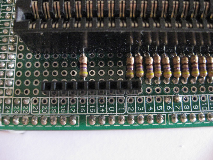

I've made a pcb for it, since I didn't want to rewire my old build for adding the full lenght slot. It should arrive in 2 weeks time. Well worth the saved time compared to wiring everything per hand.
If you have a closer look you will notice that I changed all the pins around. This is so that the address and data lines are grouped together on one port which will in theory give an insane speed boost since you can just do:
PORTC = myData;

Nice PCB. I might need one! I recently pulled a cart connector from a broken Retron 3 and it has the proper pin spacing.
One thing on the clock generator location, the USB connector on the Arduino is close to the pins for the clock generator on my current adapter. I put a layer of kapton tape over the USB connector to prevent a short (just in case). I also have some plastic spacers sandwiched in between the adapter and Arduino but it might be really close if you fully seat the adapter onto the Arduino.
Thanks!
I'll send you one, no problem. :slight_smile:
I tried to stay away from the USB socket but it still might conflict with the 6pin ISP header depending on the used Arduino board, but nothing a little tape or desoldering iron couldn't fix.
