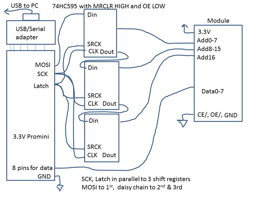

You can do this with a 3.3V 8 MHz Promini, 3 74HC595 shift registers,
http://www.digikey.com/product-detail/en/SN74HC595N/296-1600-5-ND/277246
and a 3.3V regulator for power to the cartridge.
Shift out 3 bytes of address info ( or 2 bytes and control 17th with an IO pin), sample the 8 outputs and create a data byte, send the byte to a PC.
Conceptually pretty simple.
On the PC side is put the data into a file. Don’t know what’s involved there.
At least much cheaper. Maybe I do it that way. Not much easier though IMO, in fact the same as Ardumpino and need of many connections and 3 shifters as well. Doesn't have to be that cheap.
Is there already a project or where is that ROM reader pic coming from? Coneptually everything is pretty simple for an expert. Sure USB/serial adapter works at 3V? Where can I find more details for the data export.
https://www.sparkfun.com/products/9873 https://www.sparkfun.com/products/11114
I drew the picture. kq2fd is programming something similar using ATmega1284 vs a Promini. "data export" , you mean sending to PC? Many ways to read data from a couple of ports, assemble into a byte, send out serial port. You are into details of software design at that point.

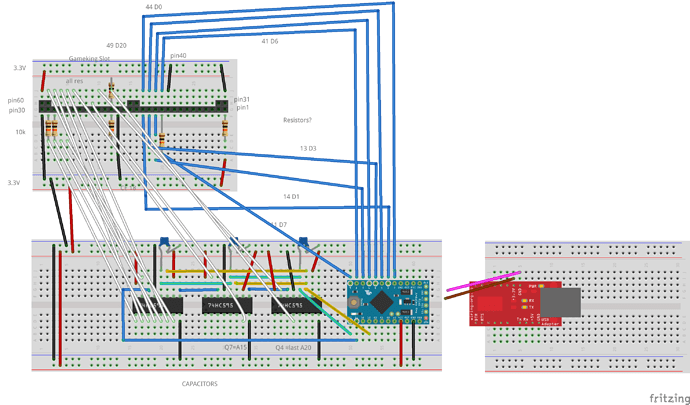

Now I’ve studied more.
I only have multigame carts which have 20 instead of 17 ADR lines. No problem as I need 3 shifting devices anyway.
This PCB rev has a slightly different pinout. But the slot still must be compatible to all carts.
I think I can use 2 Gameboy slots but I want to know the dumping speed with the given schematics as I don’t kow how long I can keep the 2 slots attached stable.
I made a project with fritzing. Someone told it wouldn’t work.
And I also wrote a code (someone told it should work) but I’m not sure about many things. Questions are in the code.
Can someone please have a look?

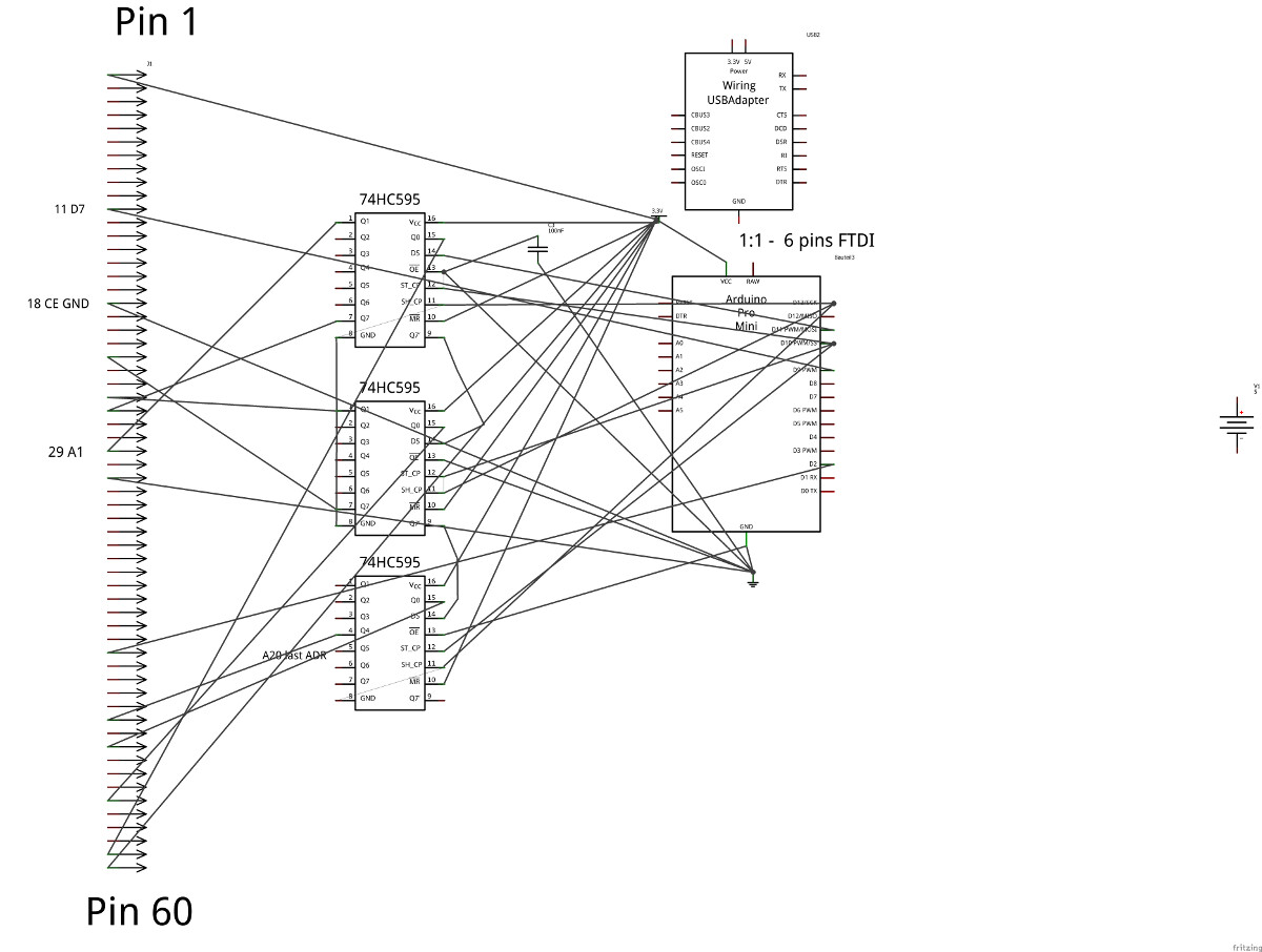

Got the intended schematic?
It's yours.
I made a new schematic. Sorry if it's not the standard and I haven't wired all ADR lines. I haven't used fritzing before.
The question is, if the main logic is correct (how to wire CE, SRCLR) and if I can use pin 10 SS as latch pin, and (values of) resistors and capacitors.
Although 20 ADR lines, the multicarts should only use 512 K, Still the question for the dumping speed and if the code is correct or can be optimized. How about coding with FTDI drivers and USB speed. Same code as for serial connection and internal conversion? Maximum speed for USB 2.0 or 1.1?
