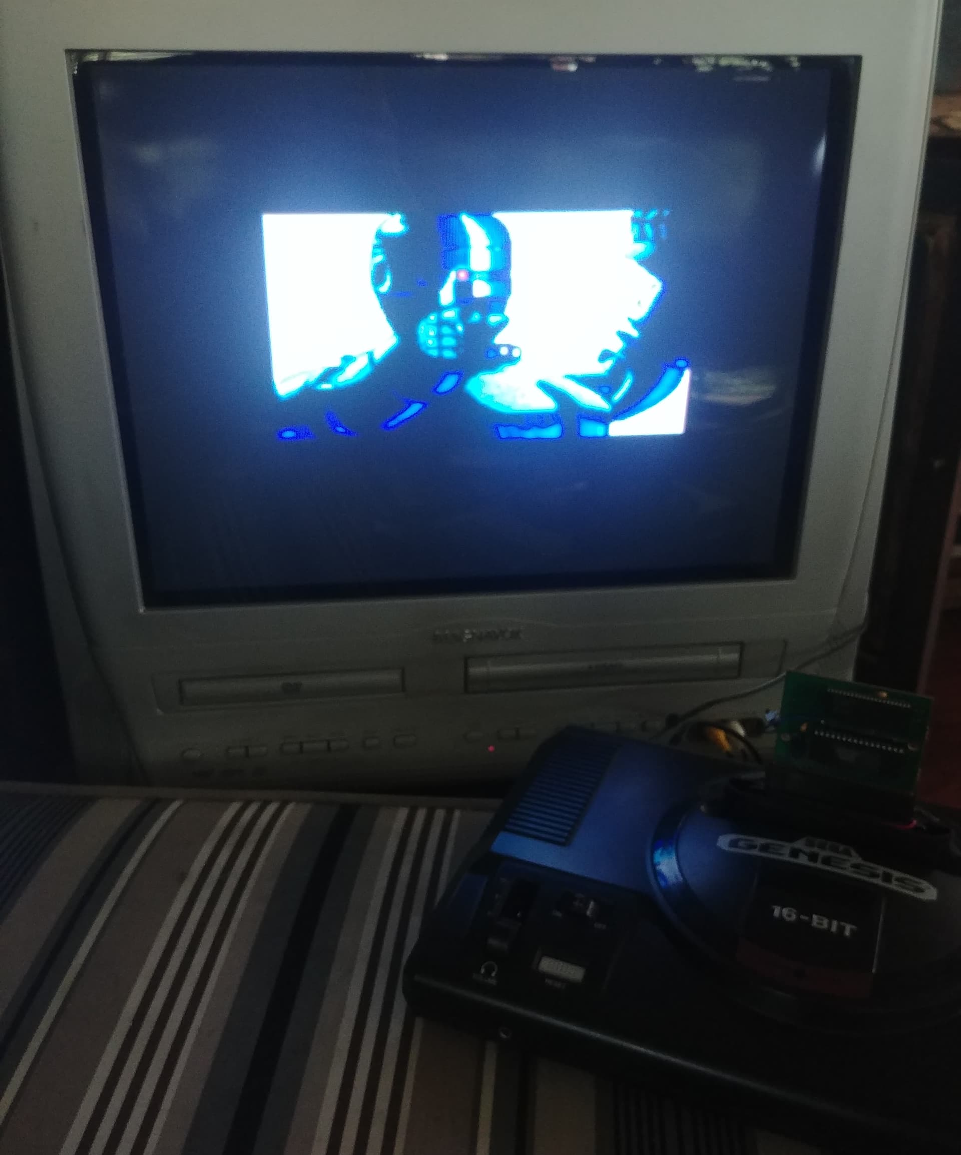

I got really curious about the SMS adapter and its ability to function as a power base for SMS games on Genesis/MD.
I got all this info from
This is what the Sanni SMS adapter is based off of. Just short R2, R3 R4 and R7. When I added the resistor to R1 for pause that function did not work and it would not work for dumping. Corrupted SD card!! Like this it still works for dumping and power basing.
It differs from other adapters with the R7 that needs grounding so the cart detect and another line go low on Genesis side. Must short that R7. This is what stumped me until I traced the signals.
I added the stack initialization circuit so all games boot no issue on MD/Genesis based on the multiuse PCB. My Afterburner cart was iffy and I would have to toggle on and off quick to get it to boot. The stack circuit fixed it. Something with that games code does not always initialize stack interestingly. You dont have to do this but its a bit of a pain to swap games and get them working correctly for no stack ones like Shinobi. Its an easy circuit and you don't need SMD parts at all if so inclined.
I booted up Monster World and the controls went nuts. Looked on Raphnet and sure enough need to build adapter with select held high for a few games. On the to do list.
*edit.
I treated myself to a Retro-bit Genesis wireless arcade pad and much to my delight it works with Wonder boy ML. No need to build a dongle.
I have not tried dumping now that stack circuit is added yet.
Don't mind the power light being out. I need to fix that.
Added Stack circuit
Atmega 8 binary. HFUSE=0xD9 LFUSE=0xDF
