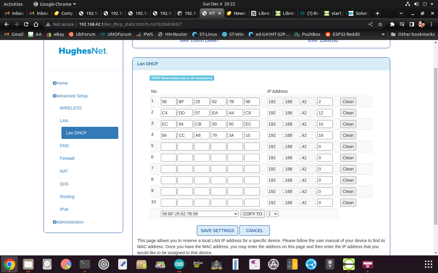

Router reassigns local network addresses for Arduinos/ESPs after restart
I am using the HughesNet Dish Router to communicate w/ various ESPs & Arduinos installed
in structures on my property. Everything is ok until a power blip causes the router to restart.
After initializing it establishes communication with the microcontrollers and assigns their addresses. These addresses typically change after a reboot.
According to HughesNet Support I need to pay for a "business class" membership to get these
addresses locked in. It is a PITA having to search for the controllers through the HughesNet HT2000 WiFi web portal to determine the new addressing.
Options?

I don't know about your router, but most will allow you to assign or 'bind' a mac address with an IP address. When the router reboots, it knows what addresses go to which mac address...
If this isn't available, might ask them how to use a static ip device on their system. I have a laser that is static only IP and I bind it in the router, so it will always stay the same.

Would be a pain to do it, but you should be able to set static IP addresses in the ESP and Arduino code (would need to be in the same subnet as the router, and outside the DHCP range). As the previous posted mentioned, most routers let you assign static IP leases for local devices.
I would suspect customer support for Hughes assumes you are referring to a static IP address for the router itself, which is usually limited to business accounts for most ISPs (although over the last decade I always get the same external IP address for my cable modem after every reboot, on a consumer account).
If you can disable the router portion of the Hughes HT2000 and use an external router, it should be no problem at all to set up static leases.
Indeed, I wonder if there isn't a misunderstanding of what you're asking for. To have a static IP on the Internet side of your router typically comes at an extra cost. What you do on your home network should not.
Home routers typically allow assigning a fixed IP to a particular MAC address, that is the IP is assigned to a specific device. It may not be trivial to figure out how to do this, of course.
Alternatively one can assign a static IP on the device side as long as one is careful not to use the address range the router is using for DHCP (the dynamic address protocol). It's common in my experience for the range x.x.x.100 to x.x.x.149 to be used for DHCP in home routers, so I've put static IP devices above x.x.x.150.
Finally, on an avahi enabled network, one can find devices by hostname.

Ok, I have a screenshot of the HughesNet HT2000 WiFi Router portal screen
where you can assign local devices specific addresses. I tried this earlier this year
and had issues with it for reasons my old age is preventing me from remembering.
This seems like the right area to do what I an wanting.
Maybe it will work this time as I am slightly more senile and cranially challenged....lol
Mister Ed
Yes... that's exactly what you want.
No ... static IP with customer service refers to their up/down link (WAN).
Your router has a "modem" that connects to the WAN ... the other side connects to the NAT which manages the LAN (customer.) The LAN typically has a range configured for DHCP on the LAN devices. For DHCP in-range devices , most routers permits "static DHCP" which uses the device MAC (one-by-one): thus returning the same address for every unique MAC listed. Devices not listed in the MAC table are provided dynamic DHCP.

I just finished talking to HughesNet Tech Support.
The LAN DHCP table in their router setup web page portal is where you can add MAC addresses/devices but they are in fact dynamic, not static. For $9.95 month you can pay to get static address capability. I can use the feature but if a power blip or anything causes the router
to reset it can change the address assignments of your devices. You then must reassign the devices all over again. Bummer.
"This page allows you to reserve a local LAN IP address for a specific device. Please follow the user manual of your device to find its MAC address. Once you have the MAC address, you may enter the address on this page and then enter the IP address that you would like to be assigned to that device."
So now its time to decide on a UPS or 2nd router as I am not paying HughesNet $120 a year for static IPs.

It works until the router burps for any reason. Funny thing is I have an ESP32 in my
wife's "She Shed" and whenever the router re-initializes it always assigns that particular
ESP as address number 2. The others are always different.

Just to be clear... are you saying that if you use that page to assign IP addresses based on MAC address, then if the router is restarted those details are lost?
That does not make sense... are you sure the rep you spoke to has a clue about what they are talking about?
Yes it works. UNTIL the router reinitializes due to a problem such as a power interruption.
According to the tech at HughesNet the table is cleared, the router assigns the devices as it
sees fit and you are obliged to reenter the assignments if you want to reference them as you
previously had them configured.
