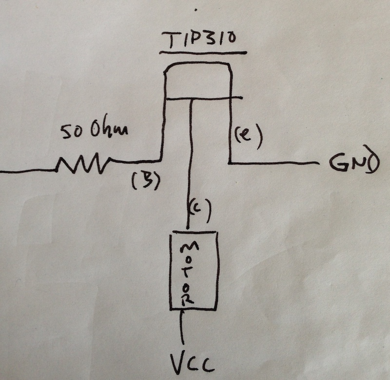

Ok...i think i get that. i must say its a lot easier when i just imagined transistors to be as simple as relays! is the included image the best approach then?it seemed to pull about the same current as when it (the motor) was connected directly....ps. You were right at the beginning. I am using a TIP31C!! Too many abstract numbers on the brain!

If you would apply the same to a relay (and point a is a thing for some relays, at least on the control side) it would be the same :wink: Then, at least for switching, it kind of be the same as: (quick hand drawing)
But yes, that would be the way (at least if you mean TIP31C ;)). Out of convention it would make sense to draw it the other way around to keep Vcc at the top and GND at the bottom. And try to learn the symbols. They tell you much more then how they connect to the device. Not all BJT's use the order BCE.
Also, again, BEFORE you then turn off the transistor be sure to make the servo signal line HIGH or floating (aka input)!
