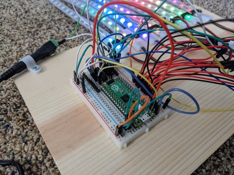

Does anyone know of a way to use the Adafruit_NeoPixel library for the RP2040, but NOT use the PIO's?
My project already consumes all PIO's for more pressing and timing critical I/Os. The RGBW NeoPixel (while an important) is rarely updated.
Recommendations for other libraries welcome as well.

The RP2040 . . (specifically) . . has 2 special state machines that have to be programmed in assembly. These state machines can do wicked fast stuff and run independently of either main core. The engineers with Adafruit (when dealing with the RP2040) decided to use these PIOs ( not general digital I/O ) to run the NeoPixel . . well . . because you can get hyper performance that way. The thing is . . that's why I chose the RP2040 . because I needed those PIO's for other things.
So . . that leaves me in search of a library for the RP2040, that uses general I/O like NANO, or other low performance processor would. . . or a way for the Adafruit not to use such a valuable resource.

Have you actually tried it? A quick look at the Adafruit library implies that you can select the state machine and the pin you want for the NeoPixel string. You haven't shared any of how you are using the other state machines so it's hard to speculate further.

Really? Back when I was tinkering with the RP2040 I used the 2 PIOs with 3 distinct peripherals simultaneously with no issue: a NeoPixel ring, a DHT22 and a DS18B20. It went like this:
Claim an unused state machine on one of the PIOs.
If you can add your program to the PIO, do so.
If not, try the other PIO.
If you can't add your program to this PIO, fail.
Add your program.
Get the default config, set your clock and pins, and initialize and enable the state machine.
Done.
You'll likely run out of PIO program space long before you do state machines. That's been my experience at least.

FastLED . . utilizes the PIO ( You can find the PIO.h under src/arm/rp2040/ pio_asm.h
FastLED_NeoPixel . . utilized Adafruits_NeoPixel, which uses the pio also.
It appears the same original solution is being recycled. Part of that makes sense, because, setting all other system demands aside, the PIO is a beautiful way to solve the problem.
When you have a complex system and need that (PIO) hardware for other things, you need to solve NeoPixel communications like you would on a NANO or anything else other than the RP2040.
At this point, I believe we will have to write our own library. It's not the end of the world. I'm just a little surprised that the only solutions (that have been found) use the specialized PIO hardware.
