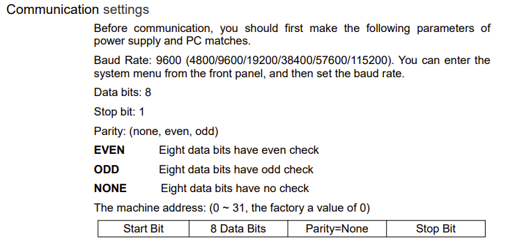

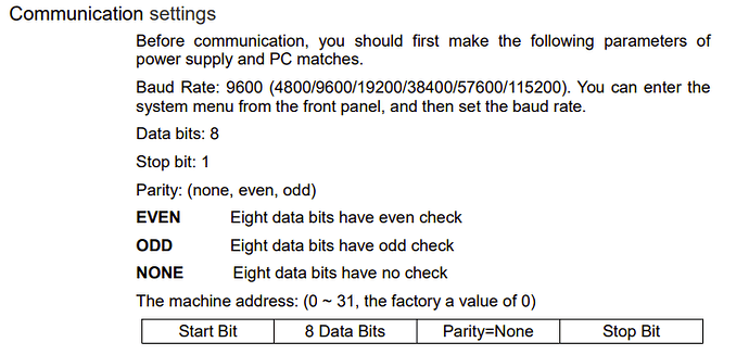

i don't think so. Maybe this helps:
Does this mean that the DB9 cable may not swap the pins between input and output?
null modem
Depends on the cable, some swap the Rx and Tx pins, some are wired straight through.
For equipment designed to be connected to a PC, the only thing you can reasonably assume is that the cable is wired to work with the standard serial port of a PC. The RS232 adapter for the Arduino may not have the same pinout for Rx and Tx as a PC port, depends on the adapter you have.
I built one. There is a handshake protocol which i assume the device does not need if I use baud9600 8N1.
No response.
what would the problem be if that was the case?
I have no idea if that is true or not.
Post the users manual for your device.
What problem would you see? The exact problem you are seeing.
