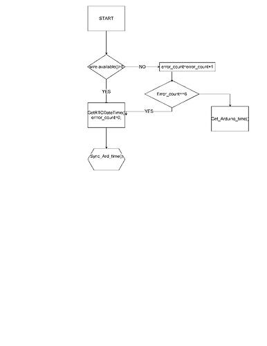

Dear all,
I am trying to do simple program where its flow chart as below.
1)how to run Arduino time , is there any library for it.
2)how to syn arduino time with rtc time()?? any coding example??mean to say if RTC failed it should run on arduino time.
please help me in above two issue either in coding or sharing some link
if nothing worked,what will be alternate option.
option 1 in my mind:
board : arduino UNO v3
it has limited eeprom i.e 1kb .

I wanted to simple way.I have RTC DS1307 . Assume that my RTC has gone bad , i wanted to run my program on the basis of Arduino time.Arduino time run on basis of timer of MCU. if arduino board get shutdown it might set default value. SO its OK for me.@that time we can take other action or which rarely to happen , since controller are on running with battery .
pseudo code:
RTC failed can be check using Wire library.
check if (rtc failed)
yes: get arduino time
no : write RTC time to Arduino time or syn with arduino time

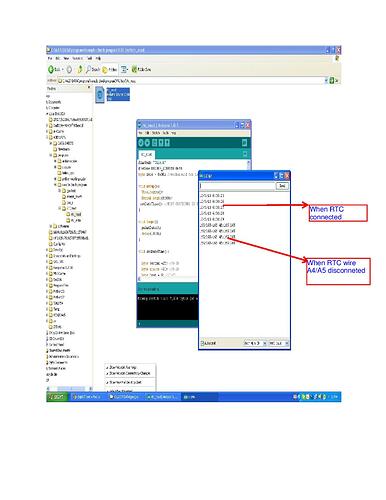

Dear all,
Below i posting pupose of above isssue. When your running over the RTC it work fine . As soon as removed the PIN a4 and a5 it show these errors. Since it cant find signal. At this instant i wanted to run on Arduino time
have a look here
http://www.pjrc.com/teensy/td_libs_Time.html
nilton61:
have a look here
Time Library, Timekeeping and Time/Date Manipulation on Teensy
I tested below code , it work fine with /without RTC. i have attached sample code i am working on . I never want to keep it main loop. I want to run only when rtc is get error
