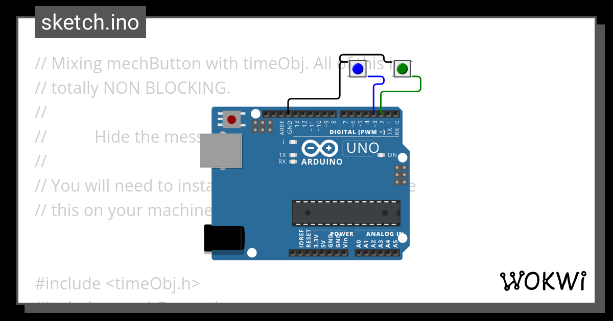

Hello everyone, I have a question. I have this simple code. It is just a countdown from 122 to 0, when a sensor is activated.
My question is, is it possible to run this code but with a different sensor signal, that starts a different countdown but in the same program and in the same Arduino, so I could see both countdowns on the serial monitor working at the same time ?

Sure, just start the millis timer, set two different flags of the time intervals you want, print out the countdown timer and just tab the output of one timer relative to the other.

Something like this, countdown 1 is what the code shows. My question is, if there is a way to show 2 or more, working independent of each one, but where all are shown in the same serial monitoring.
  • If these are separate counter variables, you can do as requested.
  • You can use a tab character \t
Here's an example of what I mean. I included noted in the comments.
This should give you a general idea. Note I didn't use tab after all, you could just space it out and call for a Serial.println(); every once in a while as needed.
Note, this is coded in the brutal style but I think gives you somewhere to start. I'm just an amateur hobbyist but maybe it will help get you going in the direction you're looking for. This requires no hardware, set baud to 115200 (or change baud rate) and is not a rewrite of your code, just an example how I would begin approaching this part of a complete project.

Would something like this work?
When you need a sensor doing multitask on the same time, it is about how you use millis().
Millis is what you use to skip some part of your program when at certain milliseconds is reached to execute your program. If the time you set is not reached, the program will skip the execution and continue with next lines of your program.
For now, you probably cannot see what is difference with delay(); and seeing the projects on youtube gonna help.
If you kept the two countdowns synchronized, it could work using delays... sure.
For your own progress and use.... non-blocking timed code will solve a lot of future questions and enable sketches to do many things at the same time down to 10's of microseconds intervals.
Beginner level intro on do many things at once. It can be read through in an hour or less and save a long time over finding out by yourself!

Hello gaston77
Welcome to the world's best Arduino forum ever.
Take a view to this example to gain the knowledge:
//https://forum.arduino.cc/t/running-and-monitoring-two-instances-of-a-countdown-timer-at-the-same-time-in-a-arduino-uno/1255529
