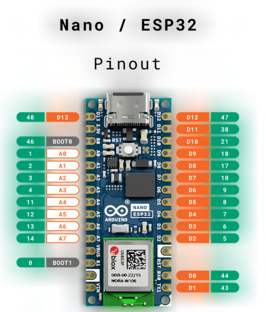

Safe pins to use on Nano ESP32 S3
i read on the web that only some of the pins of the ESP32 S3 are safe to use, while some of them are to be used with cautions, because involved in specific tasks, as boot, mode settings etc.
in detail the GPIO that are safe are the following: 1,2,4,5,6,7,8,15, 16,17,18.
the “unsafe” GPIO are the following: 3,9,10,11,12, 13,14,38,39,40,41,42,45.
i look at the pinout of the Nano Esp32, and i see that just 9 GPIO are exposed while othe 9 are part of the unsecure pins to use.

They are all safe.
What you read on the web does not apply to the Nano ESP32.
I don't know whether what @roberto59 read is true but, the Nano ESP32 uses the ESP32-S3 chip so he/she is right to be cautious
I hope that there is no confusion arising between the ESP32 chip pin numbers and the Nano ESP32 pin numbers
İ don’t think there is any difference between boards using the same processor, btw i found this information here : ESP32-S3-Zero Development Board Details, Pinout, Specs
But there is. The Nano ESP32 is one of them
As far i see, the many company producing esp32s3 in his different versions is just making different form factors and pins avalaible. Can you please explayn us why Arduino board’s esp32s3 should be different? Arduino esp32 have a different internal architecture?
If you look at the product webpage you will see that it actually uses the NORA-W106 processor which has an ESP32 embedded in it. The GPIO numbers are for the NORA not the ESP
So ALL are safe.
Thank you so much… finally have a useful reply….!
You and @vvb333007 are still confusing the NORA GPIO with the ESP GPIO
They are NOT the same
ALL pins are safe

Not really. The pinout Arduino publishes uses ESP32-S3 gpio numbering, not Nora.
And while they exposed generally safe pins, Nano still has pins B0 (gpio46), B1(gpio0) and A2(gpio3), which are listed as strapping pins by Espressif.
According to the schematics and the datasheet they are the NORA GPIOs and there is nothing that would suggest otherwise.
"3.3 Pin-out" contains a table of ESP32-S3 GPIO pin correspondence:
Thank you so much, i didn’t not knowing this detail.
Because Ublox decided to use Esp32-S3 gpio numbering...
