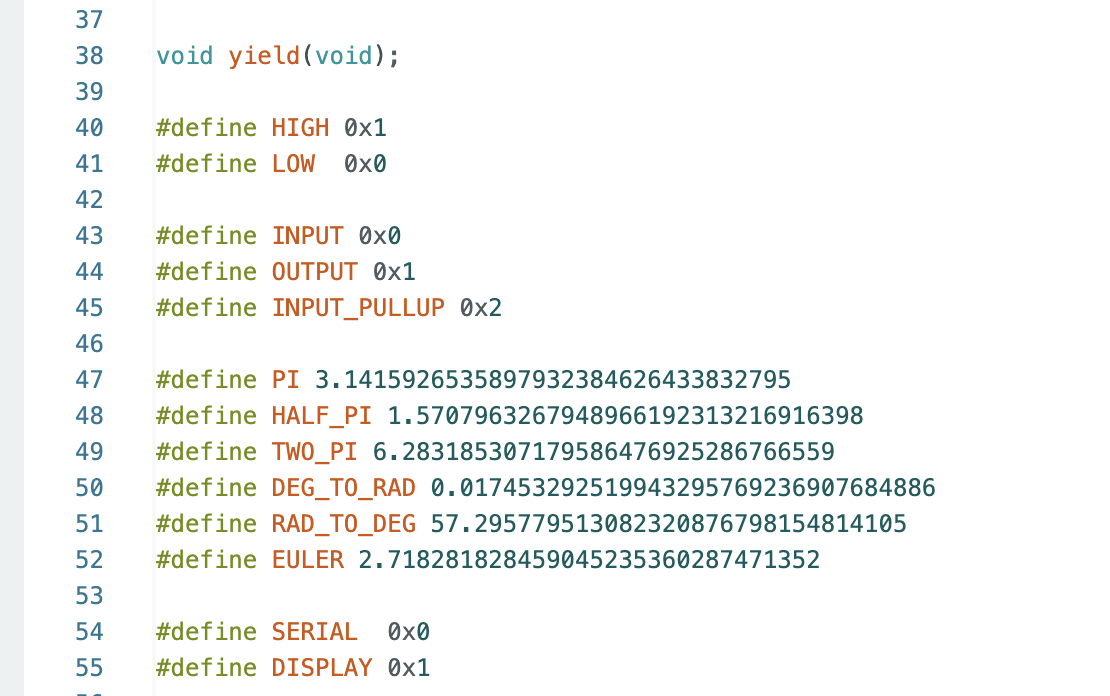

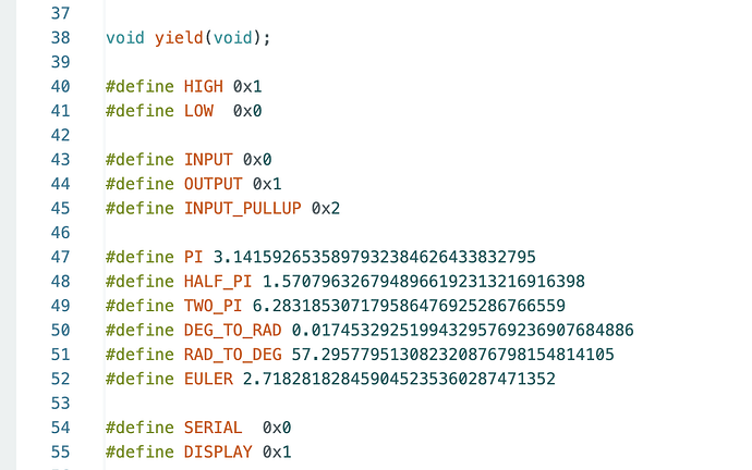

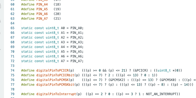

Remember, simplicitly the IDE is nothing more than a fancy graphical interface over top of the command line that does the actual work, there is nothing in the IDE that goes into your sketch other than the builtin stuff like stdio.
I put together a minimum sketch and a couple of 'builtins' there is much more. I hope this sheds some light on how things work.
