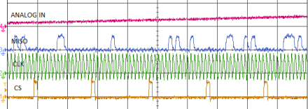

Actually, everything was fine when i was using the rectified output which is coming form the SIG pin and the reading is fine .The challenge comes when i use the RAW pin to read the Signal and sample it .At the beginning, i was using Arduino uno to sample data but uno is only 10-bit ADC so i had to use ESP32 for much more resolution and now when i sample data it looks different so i don't know is that right because the sampling change or there is something wrong

Now im able to get 1 KHZ when i printed 3 figures .In case if im using 2 sensor thus i have to print a total of 6 figures therefore, the frequency will drop again.What to do in this situation
Your problem has two sources:
First, you are measuring the raw signal, which has a bandwidth of around 200Hz; so to record its SHAPE you need a LOT more than 2 samples per period.
Second, you are using the serial interface to output results; and its SLOW.
115200 baud is ABOUT 10 characters per millisecond.
So its inappropriate for this application.
