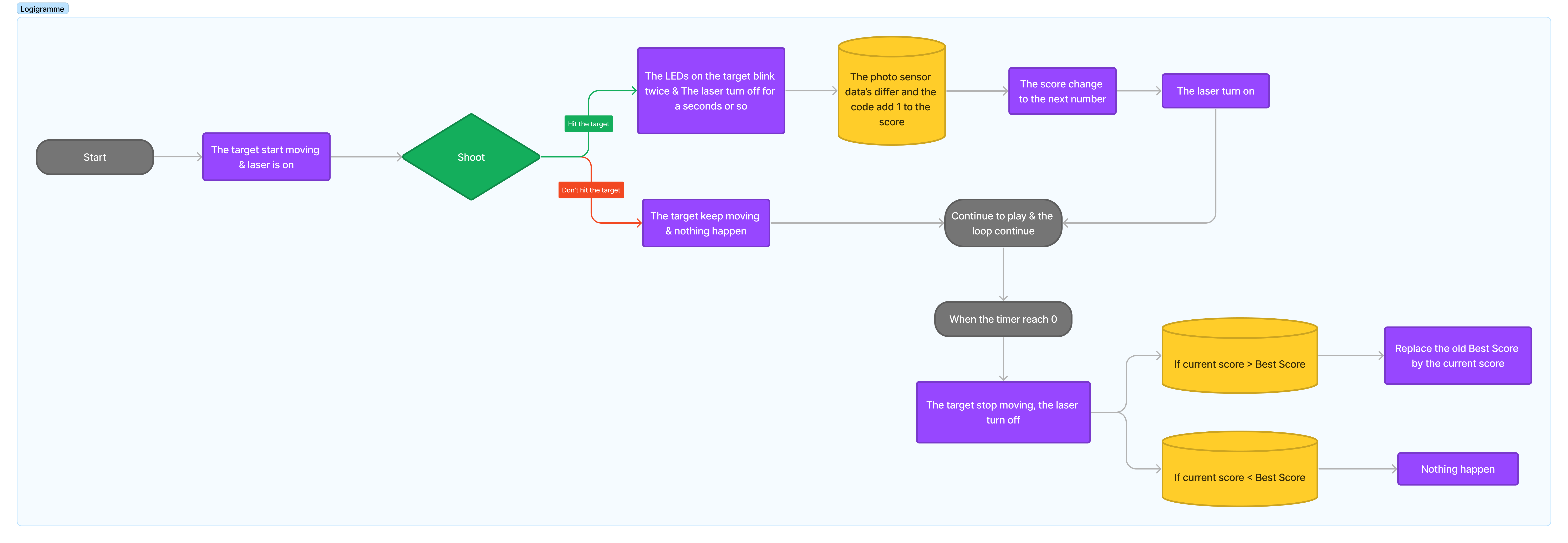

Hi Stefan,
When the game start, the laser is on and when the photo sensor is hit, I would like the laser to shut down (I don't find how to do it for now). So when the photo sensor is hit mean the laser pass over it and then it shut down.
Here is a picture of my sensor :
And here is the algo of my game :

Your diagram describes the functionality very good.
I suggest that you use a programming-technique that is called "state-machine"
The functionality has different so called "states"
state 0 target is moving and laser is switched on
  • check if shooting-trigger is pulled. if shooting-trigger is pulled change to state 1
state 1:
check if LDR-value is above / below threshold
  • if LDR-value is above threshold change to state 2
  • if LDR-value is NOT above threshold change to state 4
state 2: blink LEDS then change to state 3
state 3 increment counter by one change to state 4
state 4: wait some time to pass by
  • if time has passed by change to state 0
Oh I forgot something. But with a state-machine this is no problem at all
we add a state 5
state 5 switch off laser, stop target-moving, manage high-score wait for hitting button "start game"
  • if start-button is hit. start timer change to state 0
outside the code of the state-machine you check if playing-time is over
when playing-time is really over change to state 5
I have written a tutorial about state-machines which you can read here.
If you have any questions about this demo-code then ask them.
This is what this forum is for
best regards Stefan
