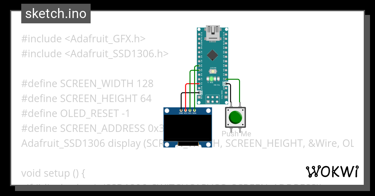

And now, scroll up:
If you are using a SH1107.
#include <Adafruit_GFX.h>
#include <Adafruit_SH110X.h>
#define SCREEN_WIDTH 128
#define SCREEN_HEIGHT 64
#define OLED_RESET -1
#define SCREEN_ADDRESS 0x3C
Adafruit_SH1107 display = Adafruit_SH1107(SCREEN_HEIGHT, SCREEN_WIDTH, &Wire, OLED_RESET);
void setup () {
  if (!display.begin(SCREEN_ADDRESS, true))
    for (;;); // halt here
  display.clearDisplay();
  display.setTextSize(1);
  display.setRotation(1);
  pinMode(6, INPUT_PULLUP);
  while (digitalRead(6)){;;}
  for (int i = 63; i > 0; i -= 3) {
    display.setTextColor(SH110X_WHITE);
    display.setCursor(0, i);
    display.println(F("Twas brillig, and theslithy toves Did gyre\nand gimble in th wabe\nAll mimsy were the\nborogoves, And the\nmome raths outgrabe."));
    display.display();
