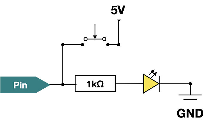

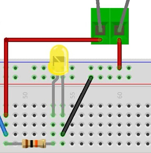

If you look at the diagram, the reed switch is fed via + on one side, then I use a 10k ohm towards the yellow LED. Also, before the 10k I connect to a digital IO set as INPUT. My (newbie) reasonning is that this pulldown resistance is between the pin and ground, and sufficient to avoid a floating state (see diagram on the right). no? I am by no means an expert in this.
2023-11-20 09_32_35-pullup vs pulldown resistor - Google Search
I don't see that here
it looks more like
or if you inverse the Red (usually 5V) and Black (usually GND) rails of the breadboard
I'm no expert either but not sure the LED would not interfere with the grounding
LEDs act as photodiodes, and generate voltages when exposed to light.
The photocurrent flow is in the opposite direction of the diode arrow, so a digital input connected to a photodiode as shown above cannot be assumed to be grounded. Voltages of 1 to 3 V, depending on LED color, can be expected.
It seems to me the bottom diagram reflects my circuit? 5V goes to Pin and 10k, and 10k goes to LED, which goes to Ground.
The pin detects the voltage change successfully, every time. Now, I am not saying it's perfect, just that from my own observations it seems to do the job fine.
If there is a way to make this better (without me unsoldering half the PCB lol) I am all hears :grinning:
I would remove the LED from the pull-down path and add it with a 220 ohms resistor to GND on a separate path on its own.
Not sure this is your issue though

I see. It avoids the PIN being in a floating state? The added benefit is that if my LED ever burns out, there is backup circuitry :grin:
