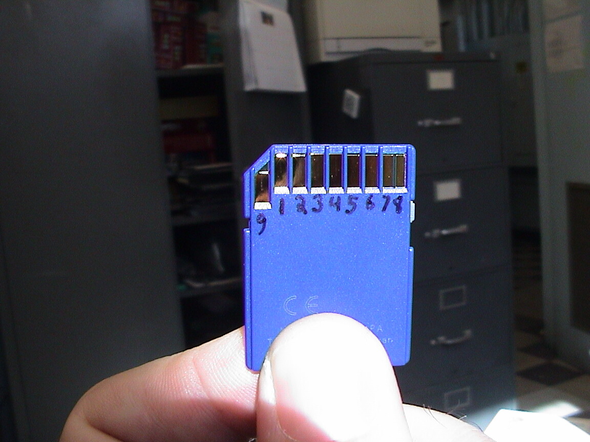

Here's the MMC pinout...
...and here's how it needs to be connected:
MMC Arduino
1 10
2 11
3 gnd
4 3v3
5 13
6 gnd
7 12
MMC Cards require between 2.7 and 3.6 volts to operate. Low power varieties are also available that work down to 1.8V, though these are special and more rare. You can power a card from the Arduino's 3v3 output if it's available on your particular Arduino variety. There will need to be some level conversion on the /CS, CLK and MOSI lines, as these output 5V. As the Arduino regards 2.4V and above as a logic high, no level conversion needs to be done on the MISO line. There are some boards out there which operate at 3.3V natively, and for these boards all lines may be connected directly.

There are 3 kinds of socket available. MMC, SD and floppy-drive edge connector ![]()
- MMC sockets have 7 connectors and map 1:1 to the diagram above.
- SD sockets can have up to 12 or 13 pins, but only the main 7 need to be used. The remainder are for detection of card insertion and write protect status of compatible SD cards. agent_orange's schematic shows a socket of this type.
- Floppy edge-connector sockets are best for MMC cards (SD cards are thicker with ridges protecting the contacts) but are undoubtedly the cheapest! Check out the ingenious hack at Up All Night Robotics, linked below.
