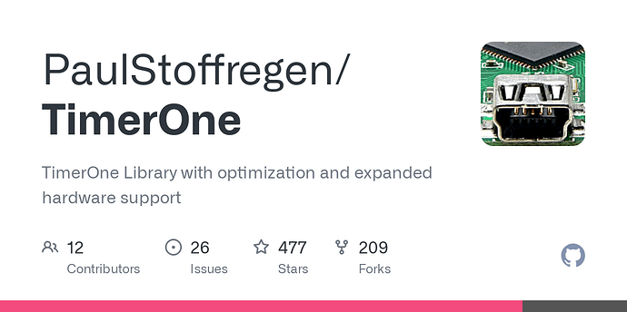

Rather than trying to use the more complicated generic library, I would use the TimerOne and the msTimer2 libraries. Both libraries have examples for periodic interrupts.
thank you
can i use both library as i wrote below
#include "TimerOne.h"
#include <MsTimer2.h>
  Timer1.initialize(500000);         // initialize timer1, and set a 1/2 second period
  Timer1.attachInterrupt(callback);  // attaches callback() as a timer overflow interrupt
  MsTimer2::set(500, flash); // 500ms period
  MsTimer2::start();
  // your program here...
if (??? ==????)     { Timer1.start(); }
if (??? ==????)     { MsTimer2.start(); }
if (??? ==????)     { Timer1.stop(); }
void callback ()   {    something1 about Serial.write  }
void flash ()   {    something2  about read button state }

Looks about right (except for the Serial.write() in the ISR) but what happens when you try it?
The Serial.write() command does not execute from within the ISR and will happen after the code exits from the ISR. It's not clear to me that the situation you saw with the millis() timer will not happen as well when using the timer interrupt ISR.
Therefore, I have doubts that the timer interrupt version of code will work better than the millis() timer version in Post #3.
The linked Due code did not have the oled display, and I think it is the blocking aspects of the display which disrupt the midi performance.
