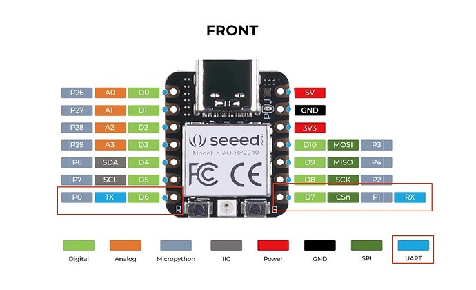

Hello together,
I want to use two serial Ports with Seeed Studio XIAO RP2040, but if i use Serial2 with defined pins and upload the compiled code to the device it freezes immediately.
So how can i use Serial1 default Pins (6/7) and Serial2 with custom pins?

when I attempted to use Serial2 on GP6 and GP7
  // reassign pin numbers for Serial2
  Serial2.setTX(6);
  Serial2.setRX(7);
  Serial2.begin(115200);
it failed and hangs the processor - have to reset using BOOTSEL button
