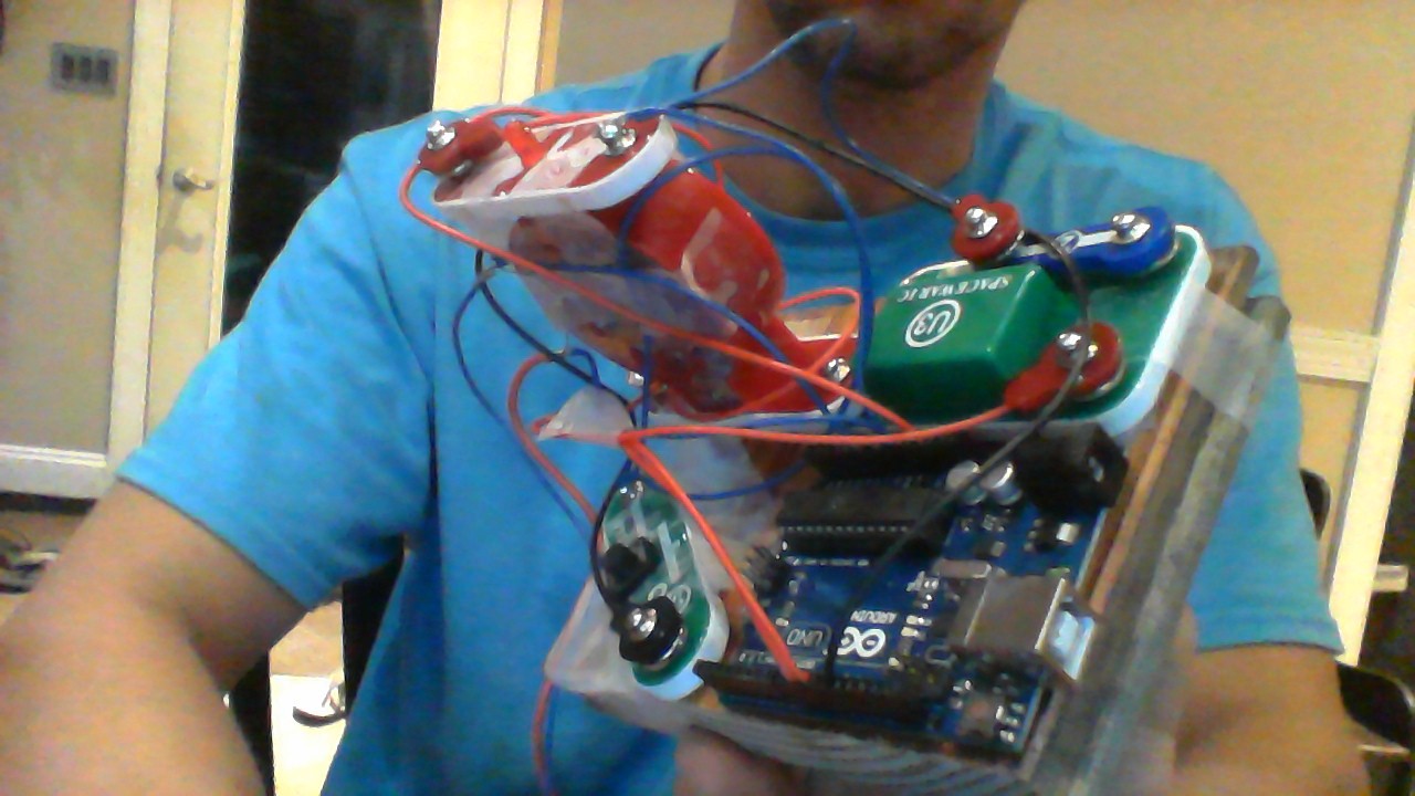

Hello all!!!
Here to tell you things are working pretty nice so far! Tinkering with the values and getting this dial in should take a few nights.
This is where it stands now
const int alarmThreshold = 125; // alarm threshold from 1 (very sensitive) to 1022
const int alarmDuration = 20000; // alarm duration in milliseconds
const byte eventThreshold = 150; // number of events before alarm | 1-255
I installed my 8 year old sons music IC from his snap together electronic kit in place of the buzzer. It sounds like stars wars,,but much better than the buzzer.
I ordered tons of goodies and some enclosures to get this in a nice package that doesn't look like the FBI is going to kick my door in.
I did order a few relay shields, single, dual and quad in case things get out of hand. For prototyping the shields should make things much easier. I also have some 5v relays coming for the final version.

as noted , I used some of my sons snap kit components. I'm waiting on the relays and other supplies so I don't have anything hooked up to that pin.. I did however put a small dc motor on it and it does work.
this is the sad prototype but works perfect!
