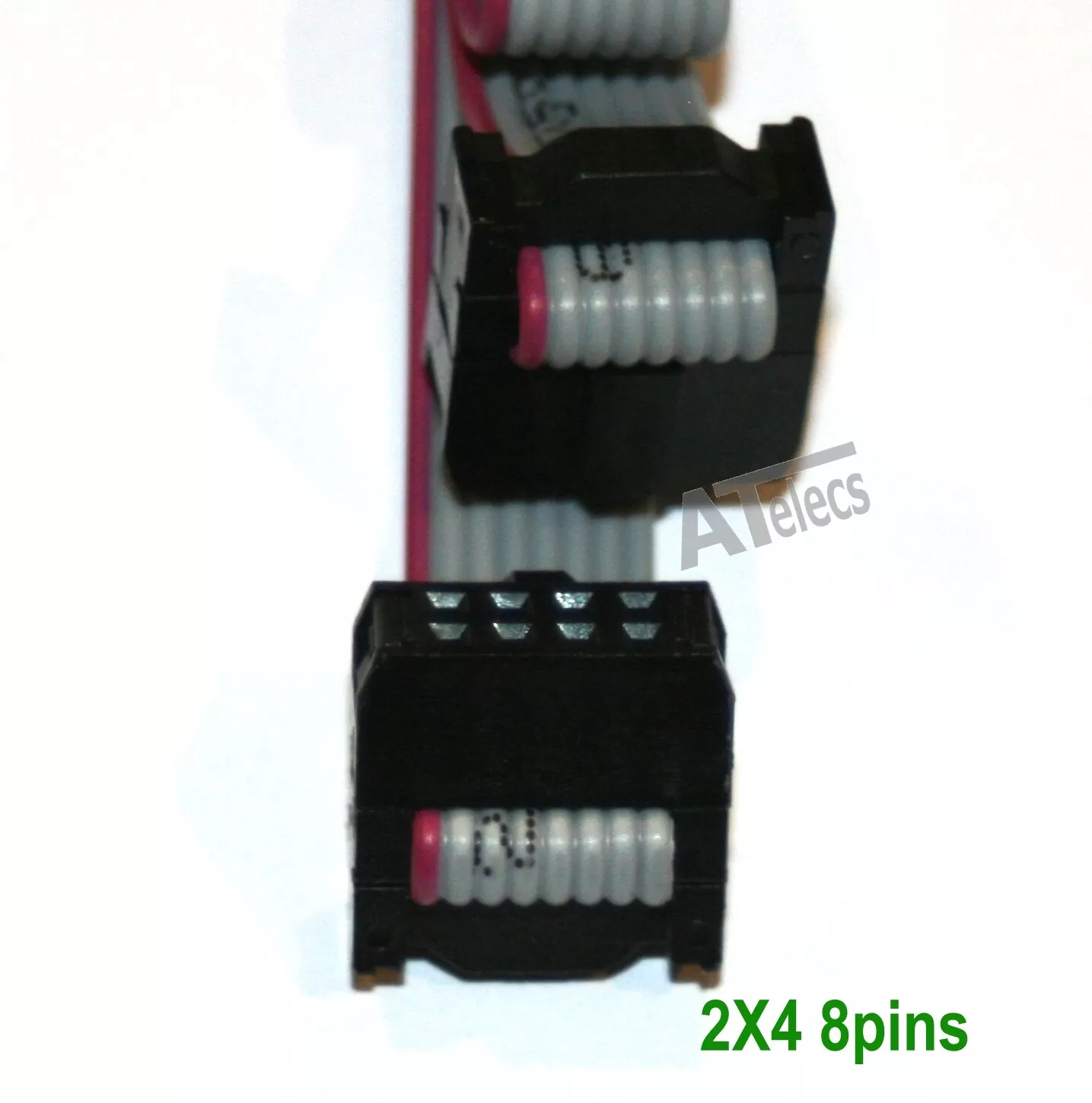

These are also not a great idea for permanent installation. Ideally you would have screw terminals or locking connectors of some kind.
Are the Vcc, Gnd, SCL, SDA pins of your modules all in the same sequence on every module, by any chance?
If they are, maybe you could use 8-way ribbon cable and 8-way IDC connectors. You would only use 4 of the 8 sockets on each connector, but at least you could daisy-chain multiple connectors onto a single length of ribbon cable.
If your i2c modules have 2 different layouts/sequences, you could use the 8 pins to provide two different layouts, each 1x4 pins, and plug each i2c module into the appropriate set of 4 pins. In other words, the 8 way cable would have 2x Vcc, 2x Gnd, 2x SCL and 2x SDA. At one end of the cable, the PCB/protoboard could connect the similar pairs of cables together.
Hope that made sense... if not, let me know and will draw a diagram. :slight_smile:
