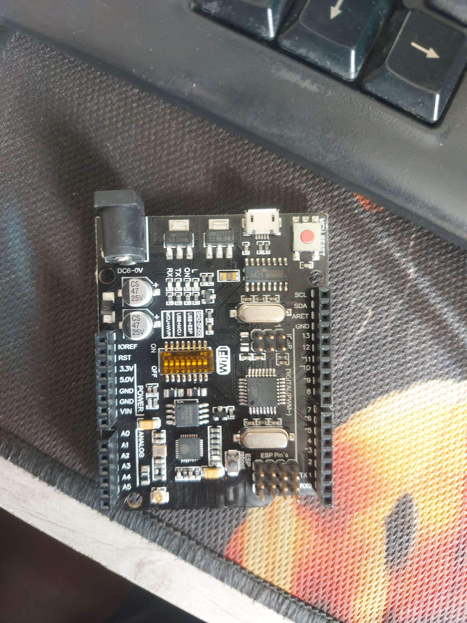

Which Arduino Uno do you have that has WiFi? Post an image of the unit along with any other info you may have on your Arduino Uno with WiFi.
thi is my arduino

set the DIP switch correctly
what DIP switch? 1 and 2 on?
find the instructions for your board and read carefully, in the photo all the switches are in the off position
As an FYI. Did you notice the words written on the board by the TX and RX pins?
"ESP" <<<< Means your Uno is a ESP8266+Uno. Just as an FYI.

choose the right type of board, for this you need to install support for ESP8266.
Here is your code compiled
