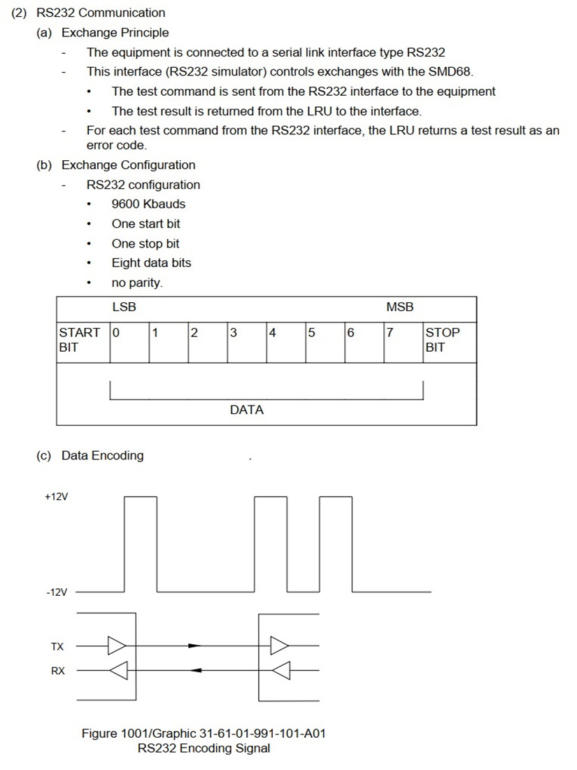

I want to send many commands through RS-232 to an aircraft display unit. Rx, Tx signal to send/receive have the amplitude -6V to +6V. As the manual of this display unit, the commands to send have the type as: "360 0 2", "610 0 1E", "510 0 1F", "503 0 EEEE",... for maintenance or reset hardware.
Can you give me some advices how to send, configure, perform,... this commands through RS-232 port ?

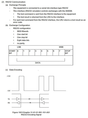

The manual doesn't say much, they just tell the information for RS232 and asking to send the commands to the device through RS232.
Here is this:
YES, M4KSerialPlus2 (for 2 channels: 0&1)
Ok. That's the basic UART frame format information. What about the format of the actual messages you need to send to the display?

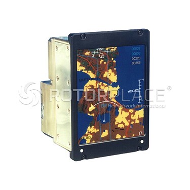

By the way, is this the display you are trying to talk to:
The outputs Tx signal amplitude of this M4KSerialPlus is ±6V. This signal connected to input (pin #13, R1IN) of IC MAX232 (Vcc = 5V). The output is at pin #12, R1OUT) that has an amplitude around +4V to send to a CPU (I guess). That Why I'm thinking If I can use an Arduino to send and read data from CPU of device bypassing the RS232 IC and adaptor board M4KSerialPlus.
Do you think it's possible ?
YES, SMD68 display
