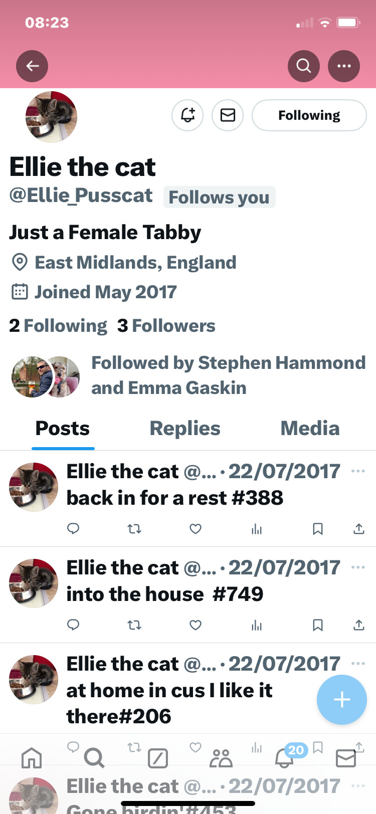

One small point I did this with Twitter a few years back and found that it detected and rejected posts that were identical to previous ones , so each msg needs to be different .
This was connected to the cat flap.
